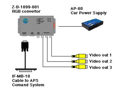

BTW - anyone know if this euro command has video out or if its possible to tap a "video out" wire from it...
I dont want to extensively mod my Mercedes like I did to my Chrysler - but its always good to know...
I might add a screen for the back passengers....
If your Euro COMAND has the 25 pin connector on the back you can output video to an external monitor.
Eurologics (http://www.eurologics.nl) has a connection set which plugs into the 25 pin connector of the 211 COMAND and converts that signal to an ordinary video Composite signal. Ask for the article IF-MB-06.
