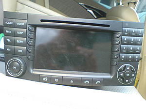

W211 Comand ??
I would like to know if this comand in US specification or Euro,, Also i have in my E500 APS50 so what i need more to install this comand to my Car..
thats a euro comand, bc it has a video button. the US ones has a SAT button. I believe you will need to add some more stuff to upgrade from
APS50..
What you have is a Euro,, command

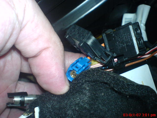

thanks, in my car where left side in the trunk i found this as you see in the photos i picked today, not that i found 4 cables too what those for?
Lucky you. You already have the mounting bracket and most, if not all of the wiring. With a GPS splitter 1-2 other parts, you're there.
