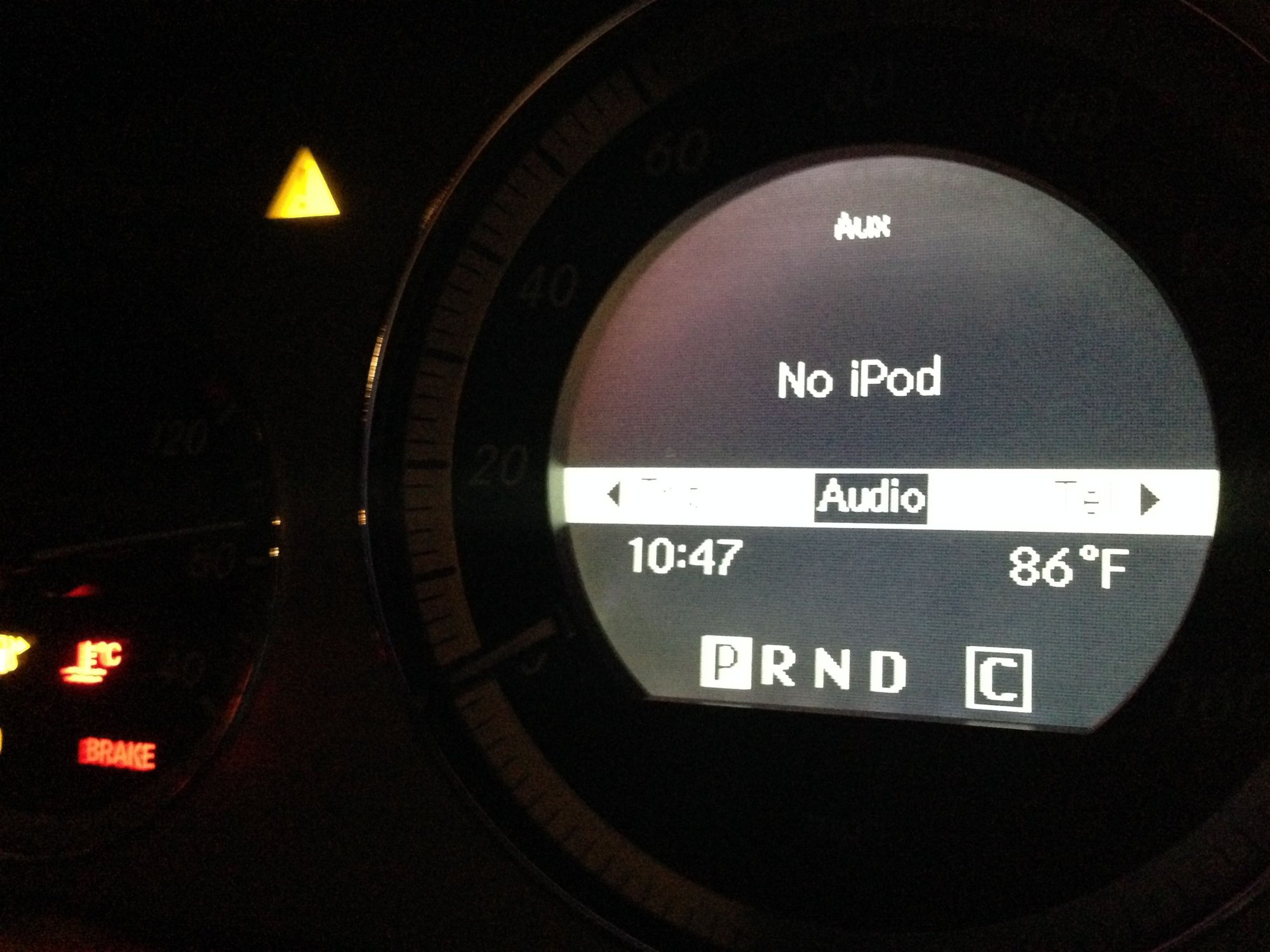

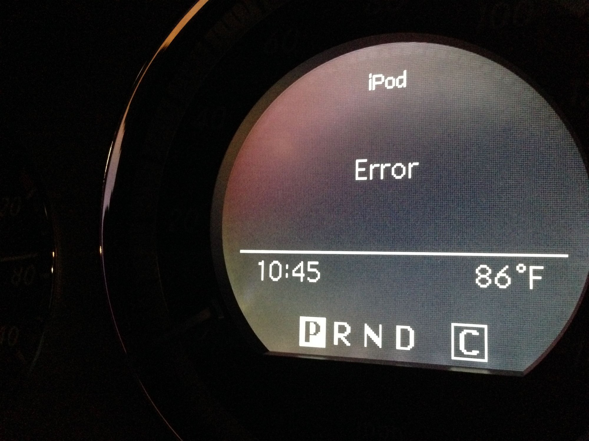

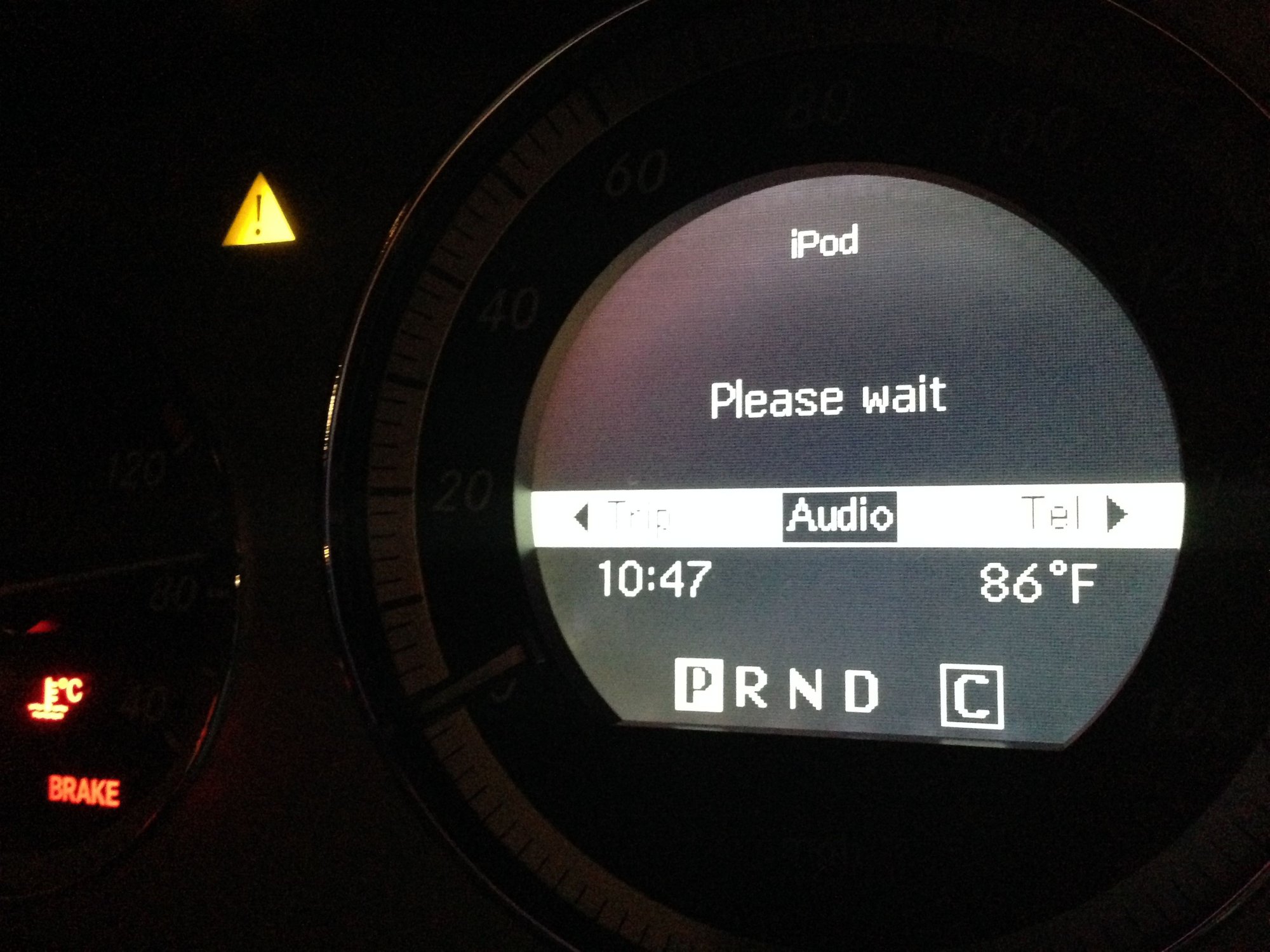

I know this is an old thread but did anyone have any luck with the regular A2DP bluetooth adaptor and 12v to 5v converter...I have both, plugged it in. and the A2DP adaptor is charging and sending signal to my phone perfectly...Unfortunately, the car does not recognize that theres an iPod attached...it sends back an "error" message followed by a "connecting" message.
is there something I have to do? some trick in pairing? I would buy the tune2air but it seems very expensive for what it does. especially since some people have figured out how to connect these bluetooth wireless devices...heres some pictures of what Im talking about...

I have the same setup as you. The display is going to give you an Error. You can't control the iPhone with the steering wheel when connected through Bluetooth.
You should just be able to connect your phone to the A2DP adapter from your phone. Then put your stereo source to AUX then play music from your phone and it should come out of the speakers.

"Should" is the magic word here...lol but unfortunately it does not. the error message stays on and then switches to "please wait" from time to time...my guess is that its searching for the iPod and until it finds it, it will not send out an audio signal.
the setup does however work on a mobile aftermarket stereo speaker system with the 30pin dock...as long as its not in the car...everything seems to work well
