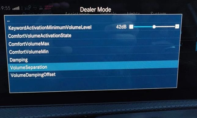

i think this one in particular is to detect your voice when the assistant is called. Have you checked this one yet?

When I set Keywordactivation to a lower level, ‘hey Mercedes’ is recognized much better. The following commands are recognized (maybe) a little better. And when I activate Linguatronic with the switch on the steering wheel, the car doesn’t hear me. In that case, only when speaking loud and close to the microphone the car can hear me.
So, a little step in the right direction but not there yet....
