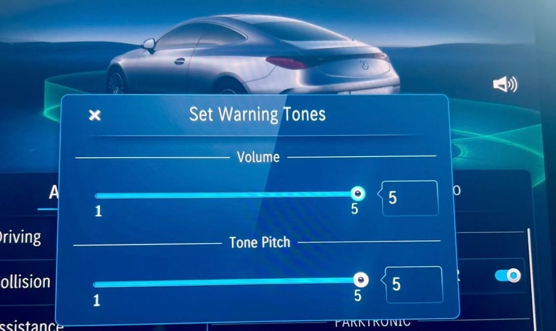

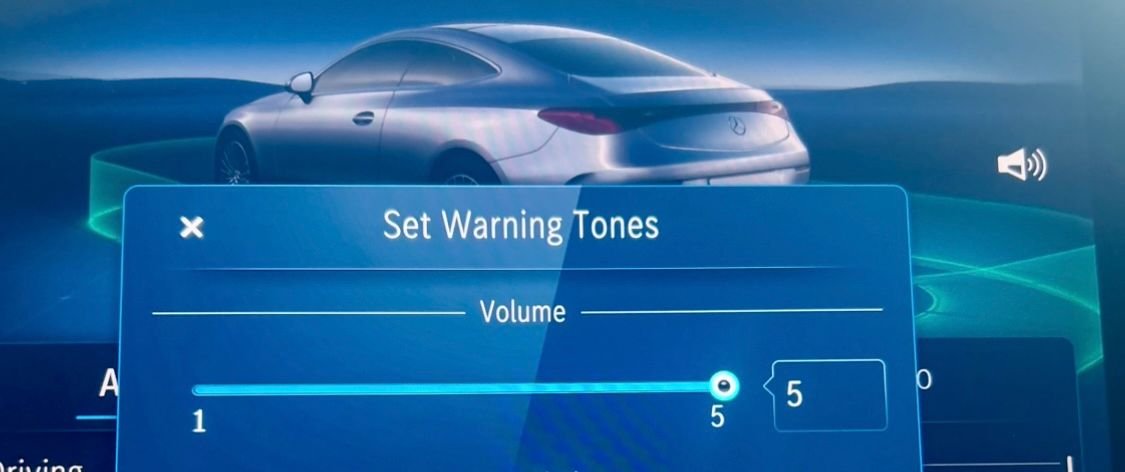

Missing Tone/Pitch Setting on Set Warning Tones
Anyone just have a volume setting and missing “tone/pitch” in Warning Tones located in Settings-Assistance-Parking-Warning Tones?
There should be 2 separate settings yet I only have one and even MB Service can’t seem to figure it out. 2024 CLE300 fully loaded.
My CLE
My CLE
The proper screen/setting options

Yes, this is a known software quirk on some new models. The Tone/Pitch setting is often missing or hidden.
A hard reset can sometimes fix it: disconnect the negative battery terminal for 15 minutes. If that doesn't work, it will likely require a future software update from Mercedes. The dealer should report it to MB technical support.

My MB Service Dept has reported the issue to the MB Technical Team. MB has to issue a SW update to correct the issue. I won’t hold my breath.

So it is a glitch and not intentional?
It’s definitely not “hidden” it’s completely “missing”.
