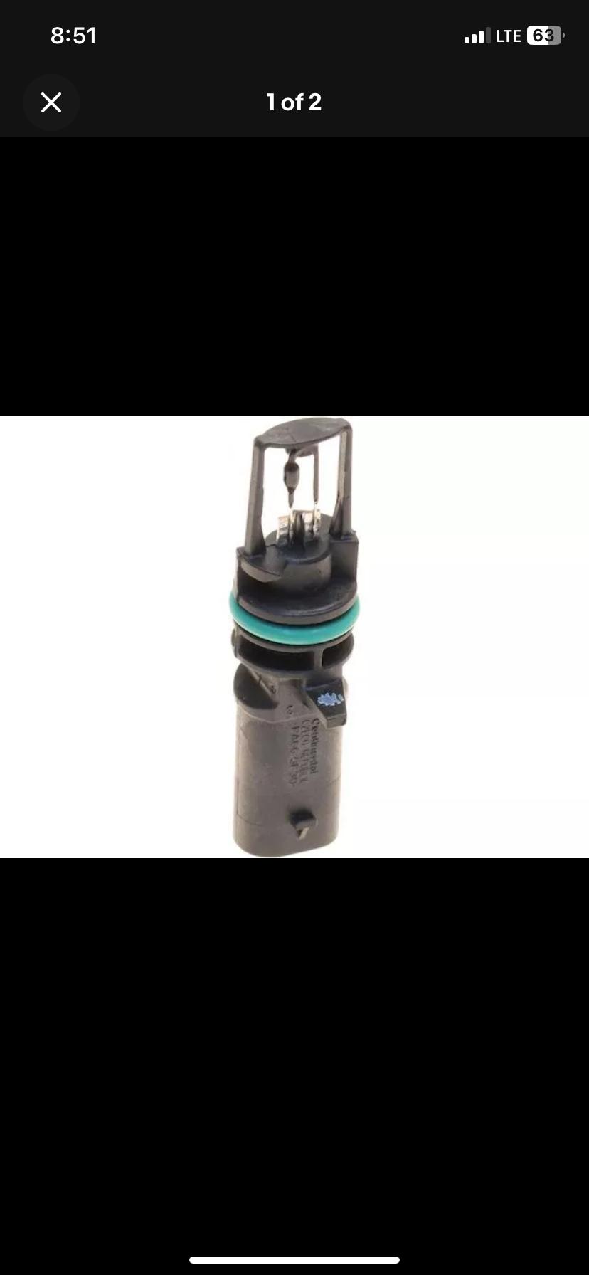

Hi All,
Getting diag code P068. This i'm told could be one of two faults with the MAP and or MAF sensor.
The MAP sensor i've found ok, but am confused about the MAF sensor location. is it the one just downstream of the throttle butterfly?
I've read that this is called the inlet temp sensor. is this the same as the MAF, if not where do i find the MAF (with pics preferably.)??

Yes it is called air intake temp sensor, m276 doesn’t have a MAF LIKE THA OTHER MOTOR

This is it…..
This is it…..

Yes that is the MAF sensor. It is confusing and I encountered thr same question when trying to find it.
