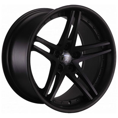

I ordered the Rohana RC5's and tires with the same dimensions as yours. Pics in my post above. [Front 8.5 et45 245/35/19 Rear 9.5 et50 275/30/19]. Because my coupe is dropped fractions of an inch more than yours, I am wondering if I will clear inside and out. Do you rub at all?

Originally Posted by dayjob3
I ordered the Rohana RC5's and tires with the same dementions as your set up. [Front 8.5 et45 245/35/19 Rear 9.5 et50 275/30/19]. Because my coupe is dropped fractions of an inch more than yours, I am woundering if I will clear inside and out. Do you rub at all?
Those wheels look great. Please post pics when you get them.
