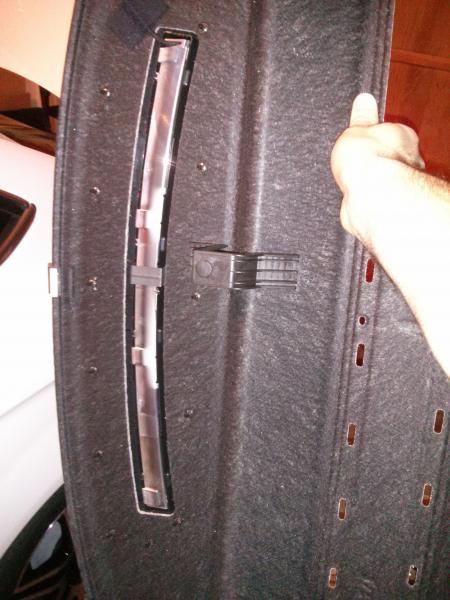

Old Jan 13, 2014 | 07:05 PM
Paul106's Avatar
Joined: Feb 2013
Posts: 32
From: Cupertino, CA
2022 EQS580
Here is the rear seat belt cover from inside. You can se the "tricky hook" and the clip on the top.
Attached Thumbnails How to remove rear seat belt assembly cover?-img_20140108_194308.jpg
