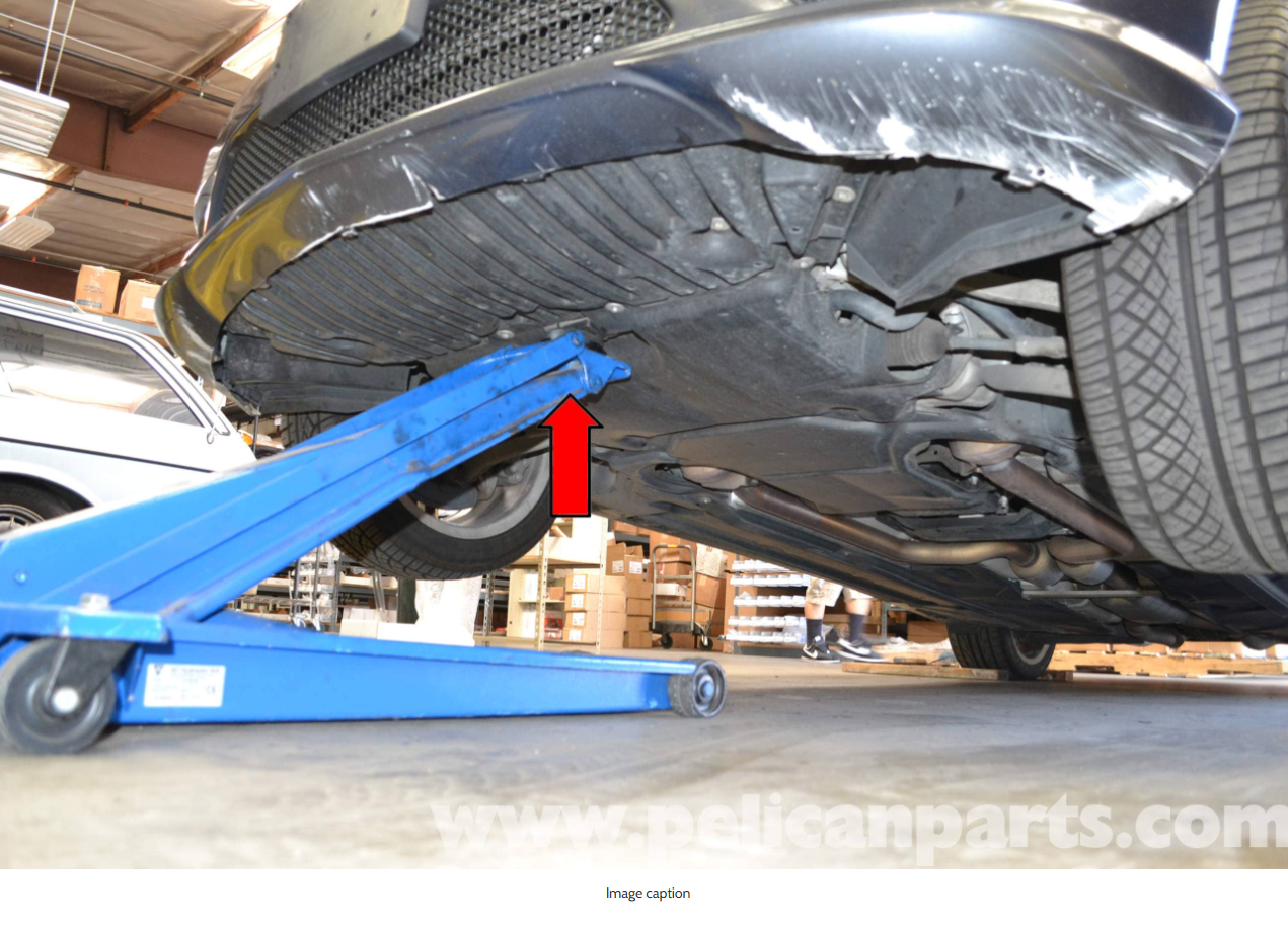

Drives me crazy that there is not a rear-middle jacking point. There is one on the front that comes in handy when replacing sway bar links and struts, easier with both wheels off the ground and stress is taken off the sway bar.
Heres a link to a Pelican Parts article on W204 jacking points. They say to use the rear diff, I personally would not. https://www.pelicanparts.com/techart...GYqlC-LsS1F2RX
