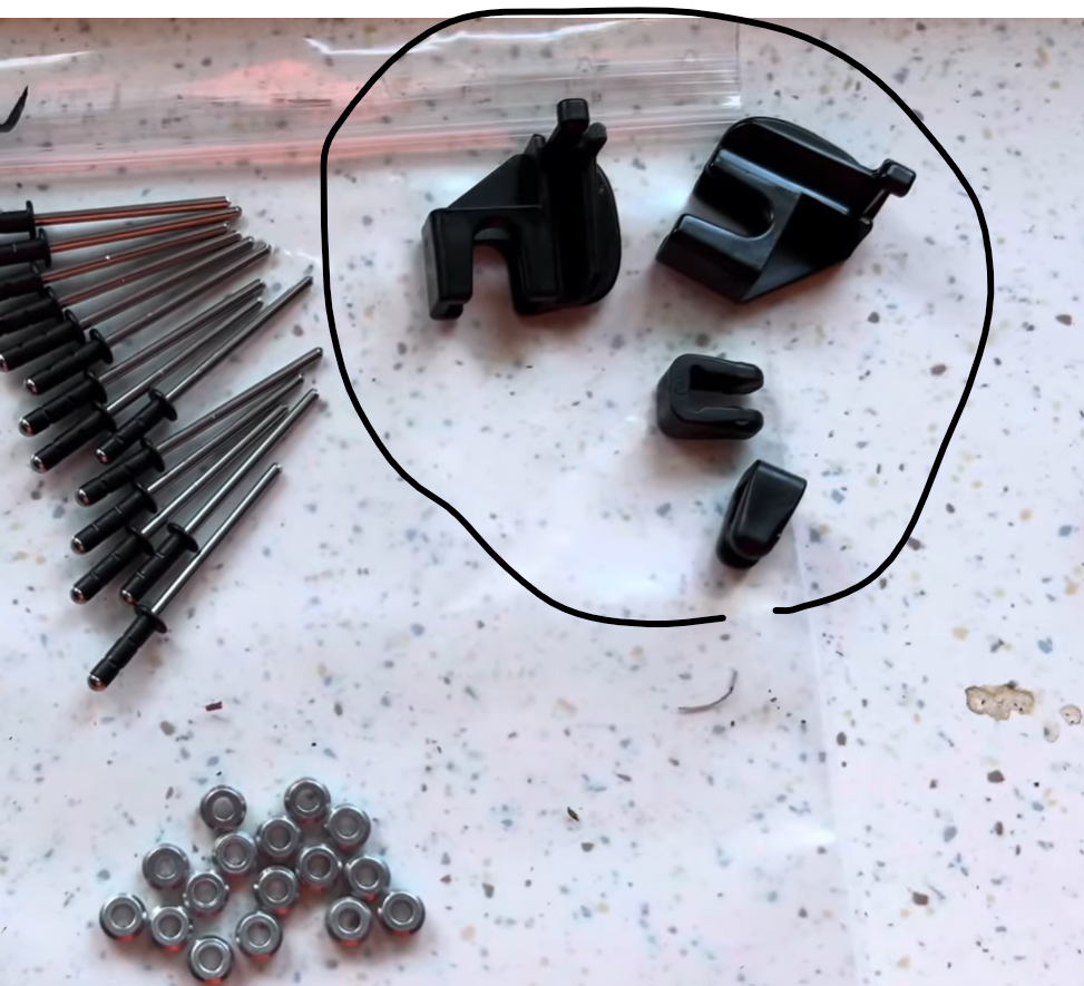

good day, the kit comes with "cable rooting clips" as mentioned in the video you referenced aswell at timestamp 1:28.
i cant really figure out where these are supposed to go. i'd really appreciate if you could point that out
image for reference:
