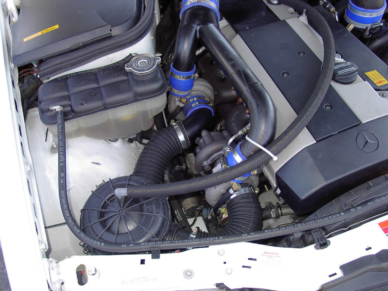

Old Apr 9, 2005 | 02:49 AM
MrSpace's Avatar
Joined: Aug 2004
Posts: 162
there is a picture I also found, don't know what car is it.
Etienne
