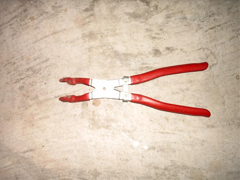

This worked for me
Having a boot puller will help you, they are not to expensive and will prevent damage if used correctly. I changed out the wires anyway when I did a tune-up just to be safe. Hope this helps

Got it. My neighbor had one of the boot puller tools. I couldn't have done it by hand alone not to mention the plugs were in there. Thought something was going to break while pulling them out.
