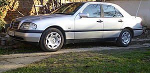

Hi! I have a Merc W202 C220D Classic and it runs pretty good, except for one small thng: when I overtake bigger SUVs, trucks etc. at speeds exceeding 90kph quite often I get pushed aside by the air flow. A friend of mine has a petrol C220 and he drove me like hundred times and that never happened to his car. I find the clearance of my C-class a bit higher than his, probably this is the problem? I have stock suspension settings and the tires are brand new Continental PremiumContact 195/65/R15 on stock rims. With the old winter tires it was the same ... any suggesstions? I also attached an actual picture of the car (still with the winter tires, but the height is the same).
