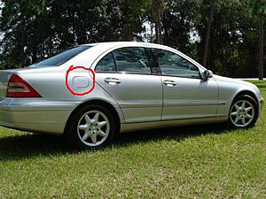

Where to buy W203 Fuel Door?
Does anyone know where I can purchase a new/used fuel door for my c-class. my current one is banged up pretty badly. i tired looking online, but no use. thanks everyone in advance

Does anyone know where i can get a new fuel door for the c240?

How about the dealer? How much can a fuel door cost (he says, knowing full well that it's some stupid expensive price)?

Hi there mleskovar! Im new to this forum. Thanks for replying to this thread. Do you know the part number? Cuz my fuel door is pretty messed up and i cant read anything from it (except for the half tire pressure sticker on the inside

Nope. Just call up any dealer and ask for part number and cost. I doubt they'll be painted though, so ask and be prepared to pay for getting it painted as well.
Sign up here to look up pn's for free.
https://epc.startekinfo.com/epc/coverage.jsp
You can check prices here and then compare to the local dealer.
Remove the "A" from the beginning of the pn to search.
Getting to be less and less dealers selling online.
Do a search on "trademotion" and "mercedes".
Actually, looks like you can do it just on the dealer site...
$66.30 + paint as pointed out.
(You can get cans of spray paint with factory color paints if you search, maybe DIY)

I never knew a site/program existed. This is a HUGE thank you!
