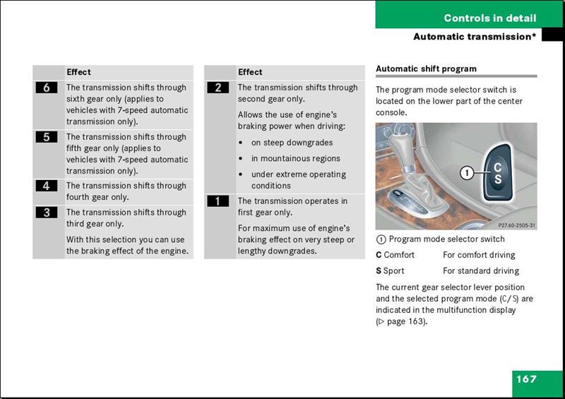

Originally Posted by buzz888
yes it is winter and standard - Not Sport. Isn't sport only in ///AMG?
People assume S means sport. READ THE MANUAL!
lol - here it is folks!!!!!!!!!!!!!!!!!!!!
