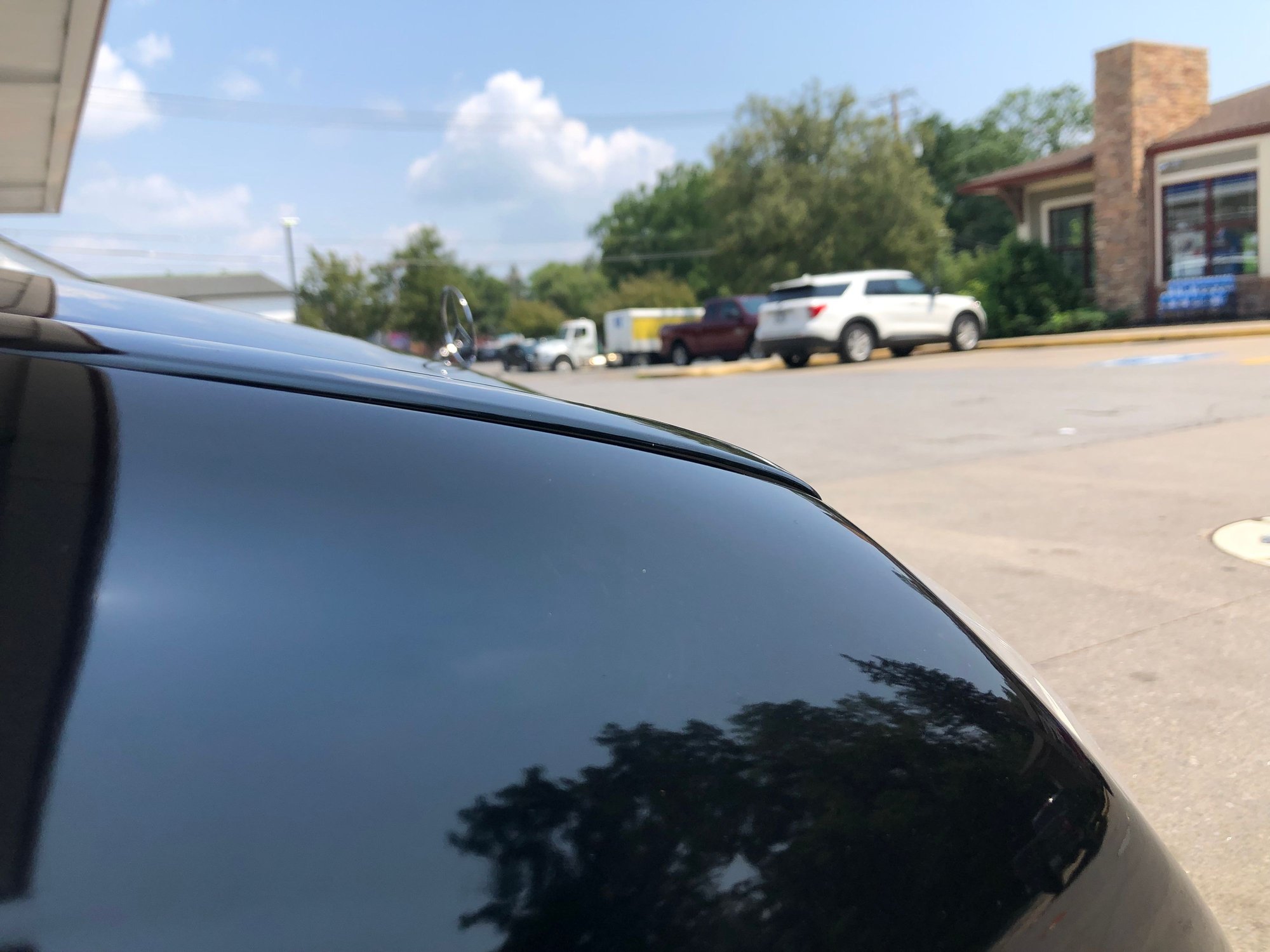

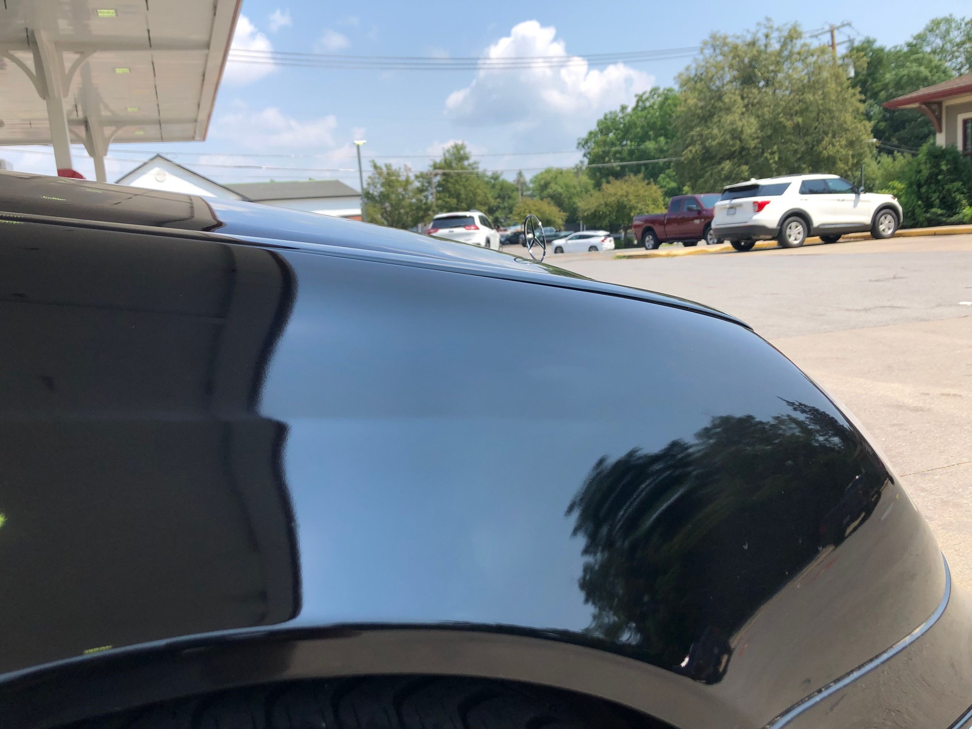

This is all I want to adjust - basically the radii of the hood.
Dealer and Dealer Body Shop recommend bending hood over a 2”x4”…not doing that.

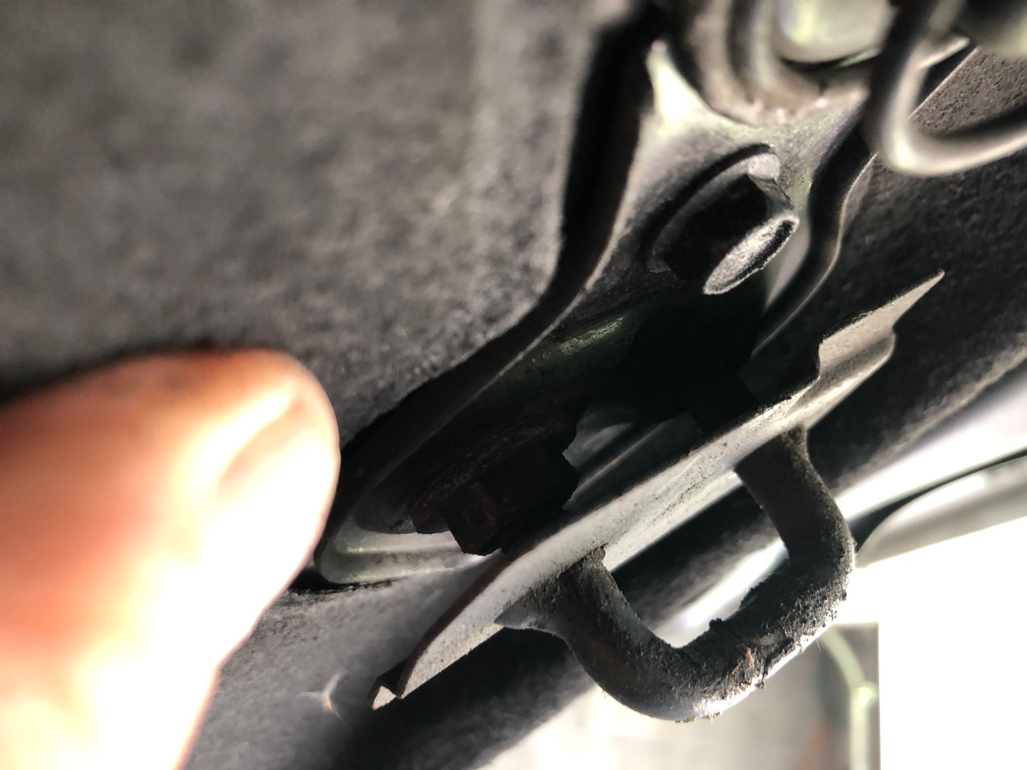

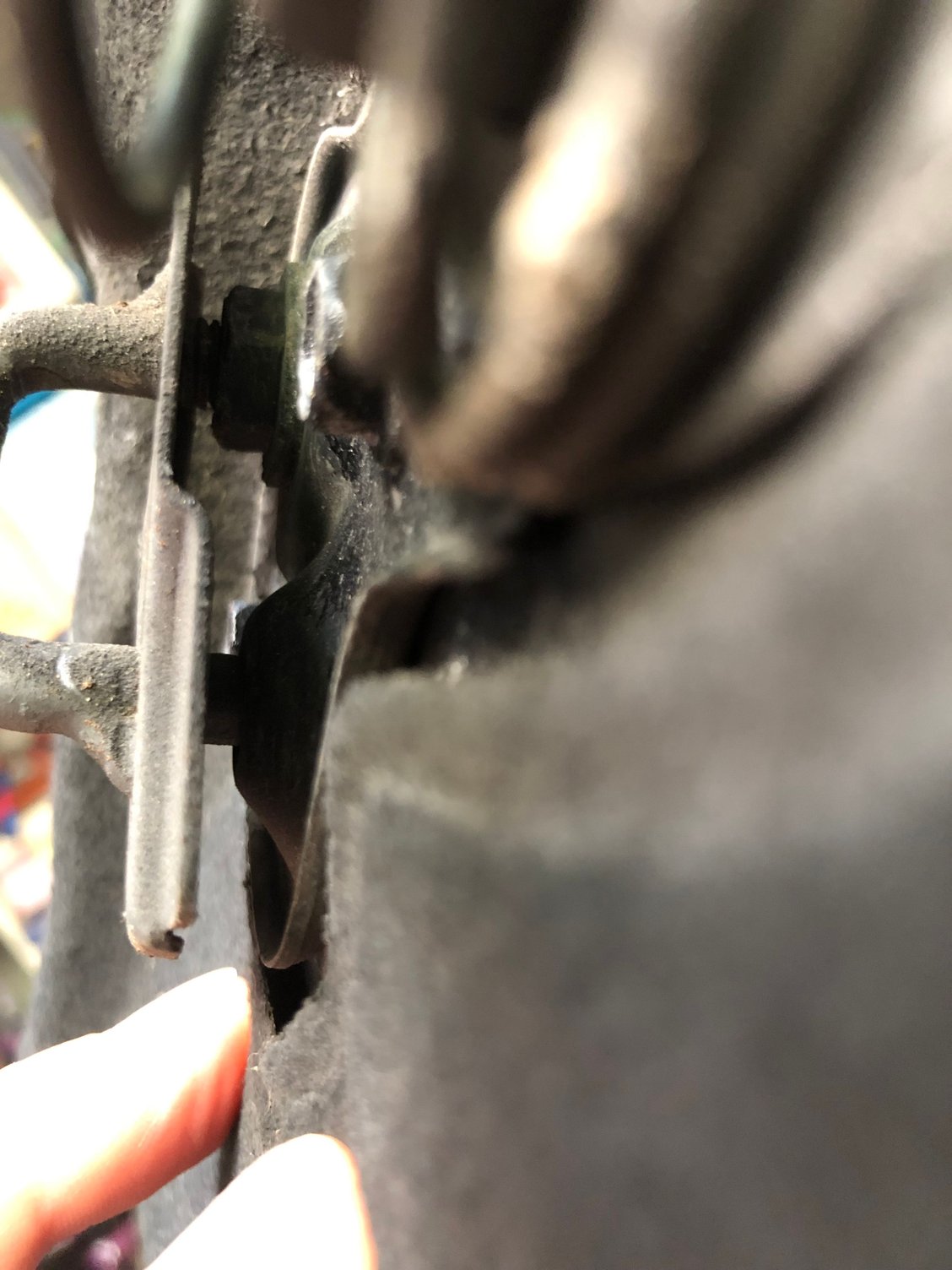

I do see what appears to be an adjustment nut behind the striker eye/hook plate…
Of course my passenger one is pretty close to touching and the driver (perfectly aligned) has some room to potentially work…
I need to double check WIS…

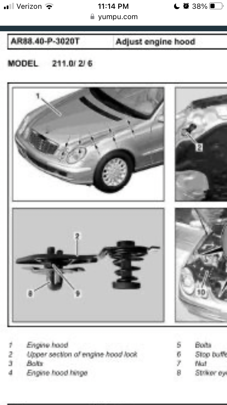

W211 seems to be more similar…
