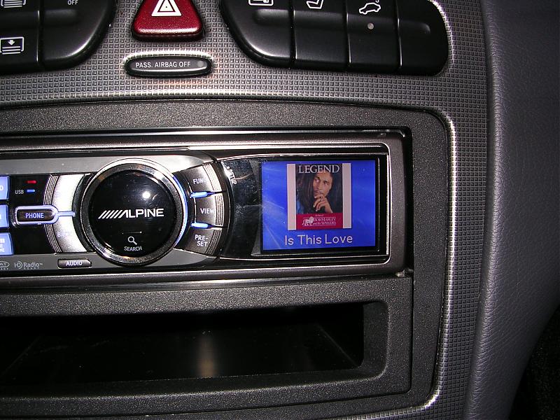

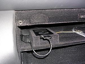

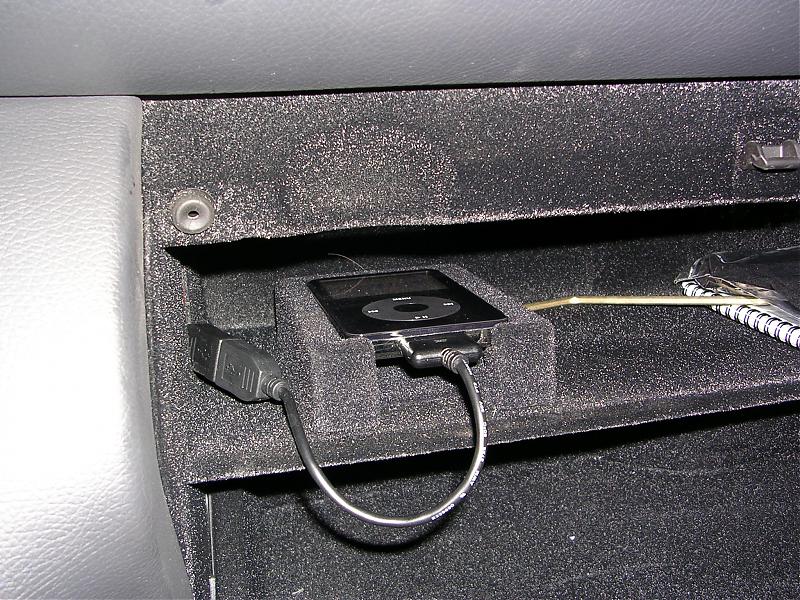

alpine ipod
I just installed that exact unit in my 04 c30 ss and I think it works great I even have steering wheel controls, volume up/down switch from ipod to radio and song or station search , you need the pac can and pac swi jack module's don't buy them on ebay because they are usually the last years model's. The bose system and amp work great you actually have aliitle more power with that hd and it sounds great.I took out my cd who needs it and i bought the factory mb ipod holder on ebay for $14.95 , you can't buy it at the stealership it only comes with the ipod integration kit (i had to call pac about programming but with there help it's easy)also those module's are only about 60 buckks apiece and they work great!
