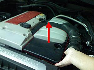

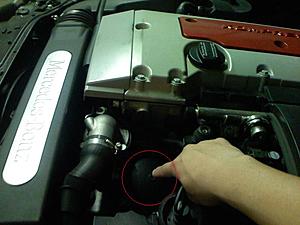

Where is the oil filter located???
I cannot find it on my 02 C230 Coupe

I think M111 oil filter is on the pass side under or near the dipstick tube? On M271 it's near the firewall on the drivers side.

Yeh, pull the cover next the dipstick.
Just yank on it, it takes a little force, but don't worry you won't break anything.
Search and you should find instructions here.

Originally Posted by spyderpig
Here the pics:
pull it up hard, you might wanna use your other hand on the opposite corner. (was holding my phone.)
Ok thanks guys..
Check out what I found from another post! Just posting it here incase someone else needs to know
here are some pics
Attached Thumbnails 03 C230 kompressor; can oil filter be replaced without draining oil-1.jpg   03 C230 kompressor; can oil filter be replaced without draining oil-2.jpg
