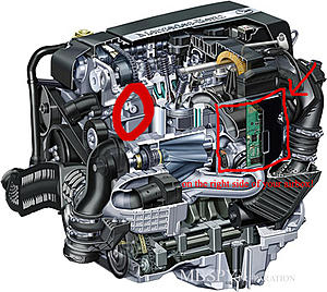

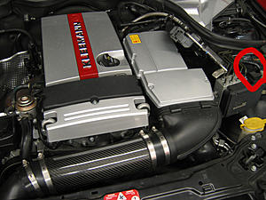

When I overboosted, it was the hose directly behind the driver side bix.. it's a small L bend... I heard the whining from inside the cabin. On other cars it's a hose directly UNDERNEATH the airbox...which will take you hours to get to if you've never done work in the M271 engine before.
Pay attention to the 'bold' circles..

My car engine is a 1.8l Kompressor and the hose you're pointing to goes on the right side of the airbox and not behind it.
I have checked it and it looks shiny and OK.

It's a hose that connects to the top of the plastic parts of the intake manifold and intake side of the head. Can't describe it... also can't get a good picture of it since it's under all kinds of stuff. All this is speculation though - I've got a 1.8L too... but you might have another problem. I still haven't flushed tranny fluid, but that's coming up next. Good luck.
