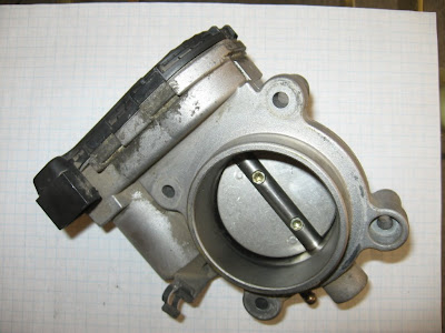

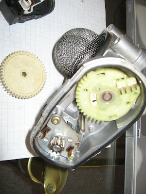

I tried something today... i disassamble the throttle body, cleared the potentioneter tracks (of what i thought was called the throttle position sensor), and put it back together. It did not help.
While trying to follow the vacuum lines, I also noticed that there is a second part exactly similar at the front (passenger side). Not sure if it has the same purpose. Maybe that's the faulty one.
I just feel like i'm trying random stuff now... can't be good.
Day after day... it's getting worse. I'm just worried that when i have an opportunity to drive it back south, it wont be able to make it to the dealer.

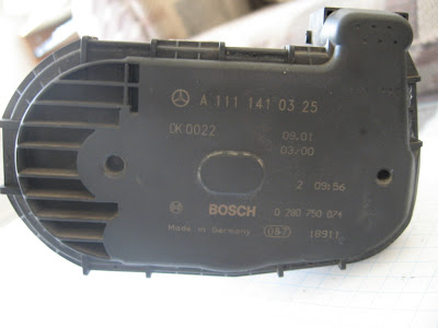

Here are some pictures of what i disassambled:

TPS is a 'hall effect' sensor. You can test it with a simple voltmeter at specified
pins on the ECU or SAM.
It's in the service DVD. I'll look for it later.
Actually search on that stupid sprint booster thread I posted all the docs there.
Start at post 423. I got ripped by these idiots for good info.\
https://mbworld.org/forums/c-class-w...ml#post2161186

Ok... time for the dumb question of the day (I'll blame it on my french)...
Is the Throttle Position sensor :
a) the potentiometer that measures the opening of the throttle body.
b) the sensor that measures the position of the gaz pedal
c) none of the above.

I thought you were speaking of the actual gas pedal on the floor.
The pics you posted are of the 'throttle body'.
Dude, you're from Labrador and you drive a C?

To be perfectly honest... i have no clue what i'm talking about!
I explained the symtoms... and it matches with the "broken TPS issue" everywhere. So... i'm trying to fix a TPS without knowing exactly what it is!
Well... i still dont know what the issue is... but i have some very good ideas on what it is not.
Oh... and my error code is not P0120, but P0121... does the magic DVD says somthing about it?
And that gas pedal is a very bad design for cold weather; the lower flexible part gets frozen... and the whole assembly acts as a toggle... so if you depress the pedal, it gets stuck that way, and I often have to reach it with my hands to pull it back. Germans should visit cold countries from time to time.
