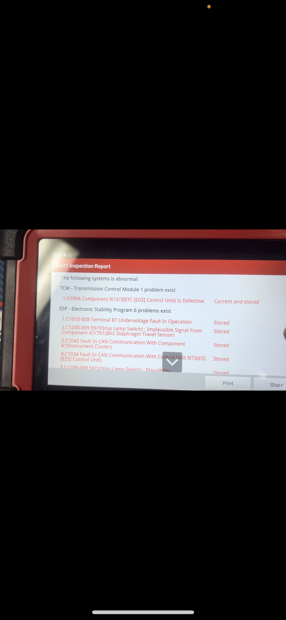

Hi! I’ve been read the whole thread from the beggining and not found the fix for me.
I got the P0012 CEL on my cls 350CGI m272 235000km
My car after a couple of km get into some of safe mode and have no power. When i stop to 0km car got vibrations. I change the magnet on the passanger site and the CEL returns i also change the cam sensor.
Previous owner change the balanse shaft and timing chains like 15k km ago.
Plug and wires to the magnet looks suspiciously to me cuz its looks different than others 3 magnets, maybe someone replace that. I check the voltage and its looks good. The voltage on the wires are 8,5v like the other 3 magnets.
So what is the next step when i replace magnet and the CEL P0012 returns?
Also when the car comes into that vibrations shows CEL P0300

vkamil; Perhaps you have oil getting to the ECU via the wires? I'd unplug the wire harness from it and check. Not sure how many cars/engines have this oil in the harness issue, but lots of people on the forums I usually surf do.
Oil gets to the plug on the ECU first, and can upset readings and what not with trons flowing where they shouldn't. Over time it can work its way into the ECU, which I'd imagine could be cleaned and still work, but hard to say with electronics.
It can also be expensive because the standard fix is to replace the wiring harness. I had oil in the wires myself, but not in the ECU. I sucked the oil out because no way I'm paying to fix something like that:
https://mbworld.org/forums/gl-class-...ml#post8771425

Hello everyone . I had a bunch of codes pop up on my mechanics scanner
He didn’t check to see what they were as I brought my vehicle in for the blower motor to be changed but I was able to record them from the scanner .
Codes !!

Codes !! Need help please
Codes !!
Codes !!
got these codes but no lights on the dash are on
