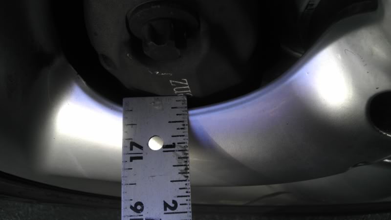

How much actual clearance do I need between the rim and the front caliper?
I'm running 32 offset wheels in the front with 5mm spaces, but I can easily put my pinky width-wise inbetween the rim and caliper, at least a 8-10mm gap.
Could I conceivably run the wheel w/out a spacer if I have so much room?
Old Feb 22, 2012 | 12:33 PM
  #7213
aznmode's Avatar
Joined: Aug 2007
Posts: 1,544
Likes: 87
From: San Jose, CA
2010 c300
My rims are 32mm offset Fronts and 36mm offset rear and don't require spacers but I too can put my pinky in between no problem so it may differ from rim to rim. But if you want to be safe in comparison, the stock wheel is about 5mm or 1/4 inch away from the caliper. But you also need to factor in the inside clearance to make sure tire or wheel doesnt rub on the suspension or wheel well if you do take out the spacers.
