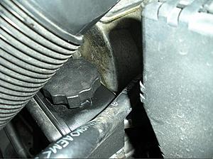

Hi everyone,
I have searched the forum for my problem. I have a 2001 C320 and recently it has developed a noise while I am steering the car to the right. The noise only occurs when I steer the car to the right. The noise occurs when the car is cold and when the car is at operation temperature. The noise is especially severe when I turn the car to a tight right turn or sometimes in slow speed (parking for instance).
A few days ago I refilled the power steering fluid, but the noise is still there. Also, around one year ago the dealership had tightened the hose clump for us and they said that if we hadn't had the hose clump tightened the steering rack would need to be replaced. The noise one year ago is exactly the same as the one we are having right now.
I have attached a picture of the power steering fluid reservoir, and notice there are some oil spilled around the area of the reservoir. Could there be a leak somewhere? And if you know, where could be the leak at?
Thanks a million for your help. I really appreciate it!

Mu & ssk - Is it only at full lock? or anytime you turn to right partially?
If it's only at full lock it could be air in the system. At full lock you have a pressure relief valve that vents & will make a hell of a noise if there is air in the fluid. Would need to bleed the entire system & get air out. I'm not sure how difficult it is on these cars. I would also expect it at full left lock but not always.

ssk - 99% of PS noises are created by low fluid level & air in the system. Obviously you should check the entire system for leaks and fix them.
Make sure that the PS fluid reservoir is filled to the correct level. Then start the vehicle and turn the steering from lock to lock about 5 times holding it at full lock both left & right for about five seconds. This should bleed the air out - yes this is true - check that the fluid level has not dropped too low. If it has - top up and repeat the exercise - finally top up to the full mark. If this works please check the PS fluid level regularly.

Yes correct. If it is not air in the system then it can be a valve sticking or on it's way out. It can be the pump or rack on it's way out. Is their any sign of air bubbles in the fluid in the reservoir
Listen to Mu it can also be noisy dry bushes on the rack or suspension. Racks last a long time - what mileage has the vehicle done?

Thanks for your reply. I notice that there are several white bubbles staying on the top of the reservoir cap.
The car has around 76000km.

That's very low mileage to be talking rack failure. If you are still seeing air bubbles in the PS reservoir. Let the car stand overnight and repeat bleeding.
