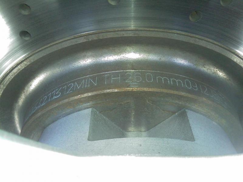

That makes sense. Here's what it says on the hub.

See image. Also on the surface of the hub it says MIN 26mm or something. I forget the exact number. Maybe that's something else.
Frank, is this not it? This is what an SA showed me atleast.
On the 04.5 Sport Rotors, 26mm is min.

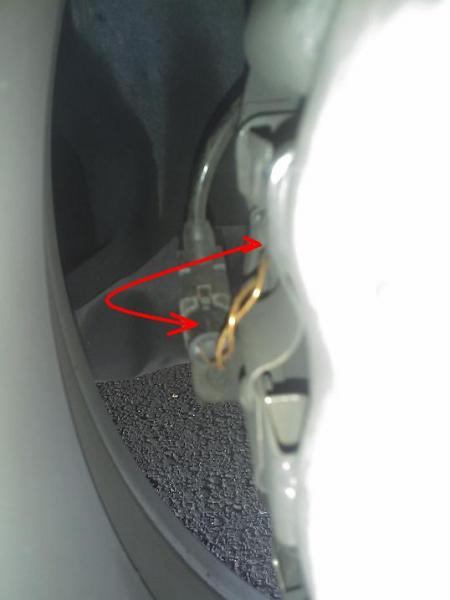

the pics in your posts are really useful. can you take a pic of the sensor? i just dont know what it looks like and where it's located.
This is the best I can do. I was able to take the other pictures with wheels on. You can't really see the other connector that plugs into the end.

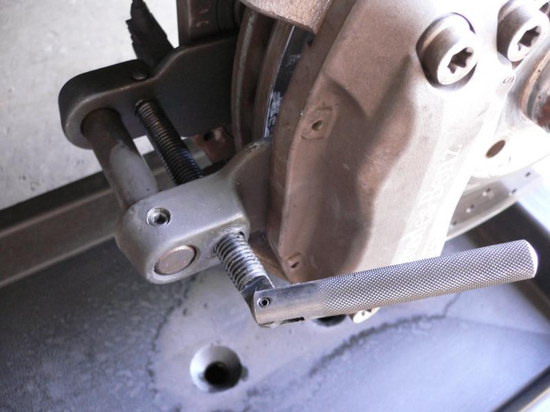

Completed the fronts this morning. I did not have to remove the calipers since I bought a piston compressor that has plates wide enough to push in all 4 pistons on my "04.5" calipers at the same time. The passenger front took 45 min due to 1 new OEM pad that had a mishaped backing plate which prevented me from sliding in the pad. The driver side took less than 15 min and that included removing the wheel, remove/install pads incl spray down with brake cleaner, and torquing down the wheel. Definitely a DIY. Also, make sure your existing rotor has not exceeded the min wear as stamped on the rotor. I have 31.4k mostly street miles and still had 27 mm left. So, my next pad change must include replacing the rotors.
That is weird, the computer will lock up if I tried to "Manage Attachments" to upload a pic in IE8. I had to do this in Firefox.
Seems my wear on the rotors was about equal - 28MM left from 80%, 29k highway miles... I too will change the rotors next time.
