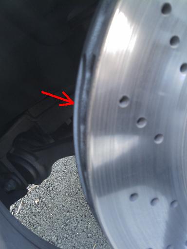

See attached image on rotor wear. I think your eye will be the better judge on the wear. There's also an indication marker on the outter rim of the disk if I remember correctly. My rotor was replaced after the 2nd set of pads about 54k miles on the car. You might be ok to just replace the pads.
As far as the sensor, it's very easy once you see it. Just unplug on both ends and the new one goes back on the way the original was unplugged.
How do you read that indication marker?? Thanks!!
there is no indication marker on the rotors.
you just feel the rotor by hand over the edge or by mm measurement to see if the pad has taken away too much rotor thickness.

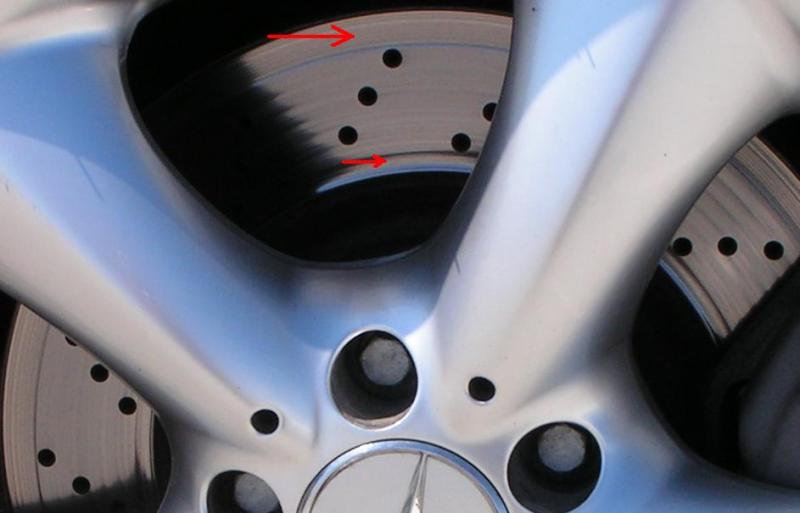

See image. Also on the surface of the hub it says MIN 26mm or something. I forget the exact number. Maybe that's something else.
Frank, is this not it? This is what an SA showed me atleast.
