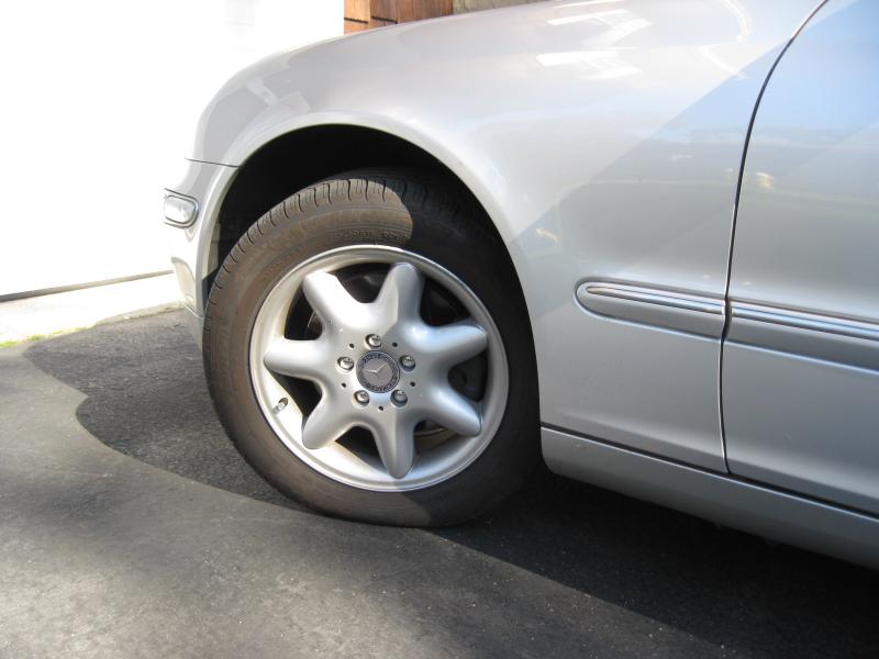

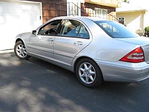

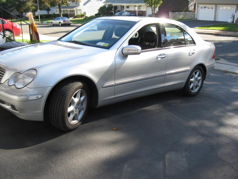

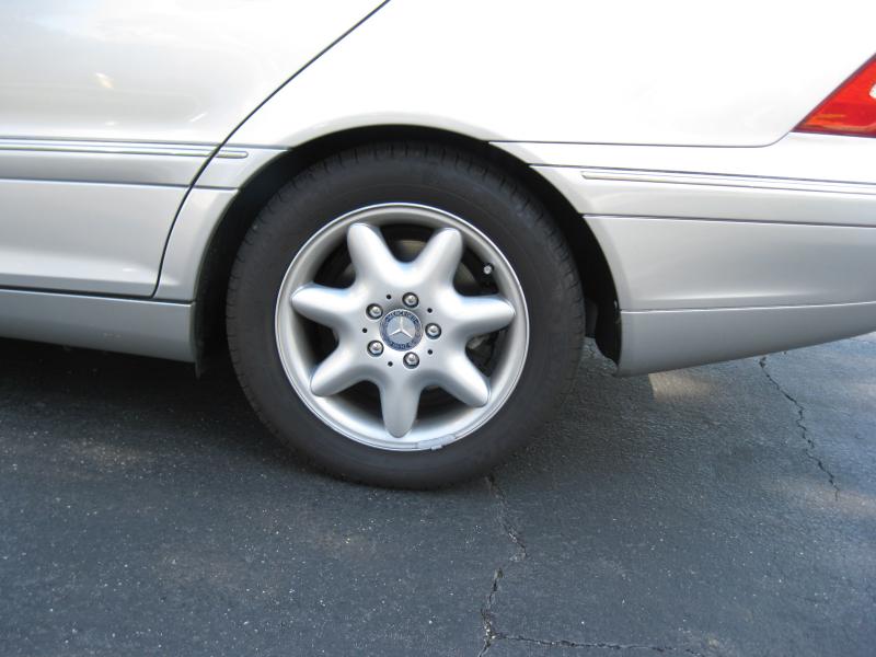

Pics of the car on the C32 springs.

i can still get some fist action in that front gap!
as long as you like how the setup improved your ride tho.

Yeah, the front did not come down as much. I really didn't care about the gap, more the driving effect. I like it but my wife is very unhappy at the harsher ride! It is, after all, "her" car!
