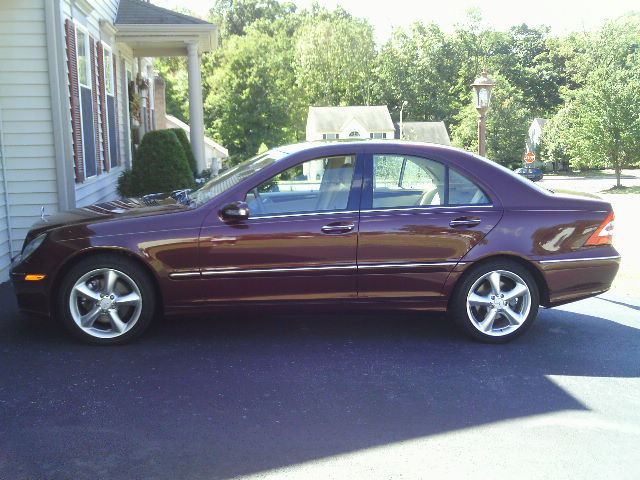

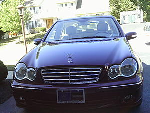

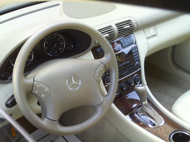

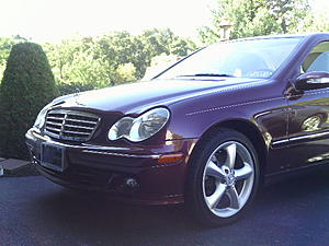

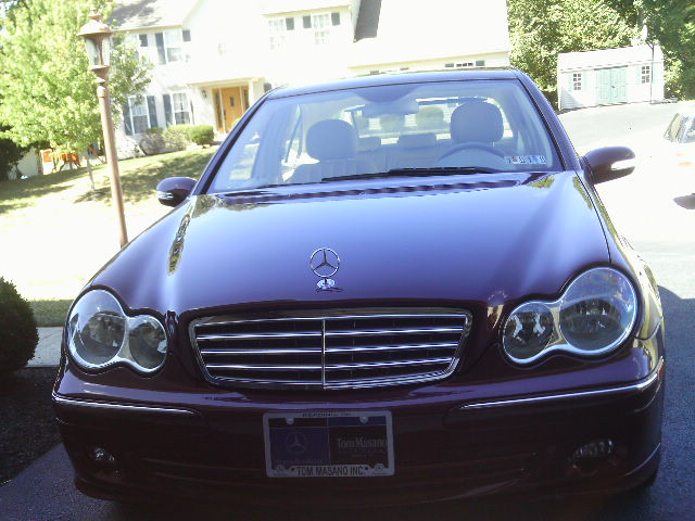

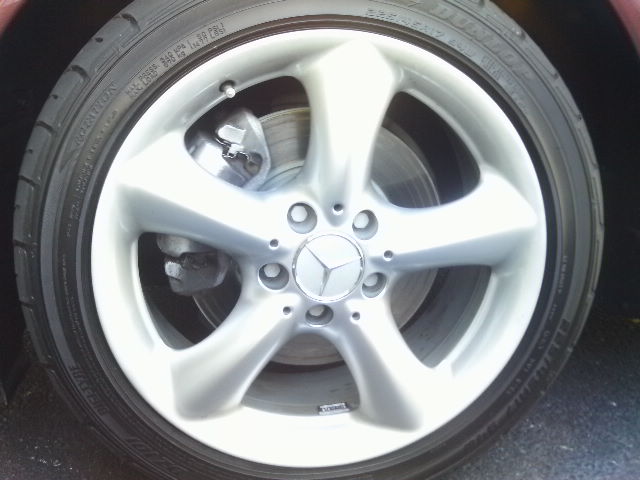

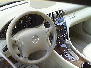

Here you go guys
Attached Thumbnails My new C Class-017.jpg   My new C Class-016.jpg   My new C Class-009.jpg   My new C Class-003.jpg   My new C Class-010.jpg

Interesting exterior color. Adding a COMMAND unit is a lot of work, not worth it IMO unless you're dedicated. You'll be looking at over $1,000 atleast. For HID's, i'm assuming you can order them from DDMTUNING.

I didn't think you could run the staggerd wheels on a 4Matic. You may want to make sure all the diameters are exactly the same so you don't damage the transfer case.

It has a Mercedes-benz dealer type plate so i'm assuming the dealer won't sell a 4matic w203 with stag. fitment.

Never assume a dealer knows better. Make sure those rims/tires are all the same size ASAP.

Factory Nav is pretty much plug and play...will take a few hours going slow and not to damage anything your first time on the job...lots of snaps, plastic screw bosses not to damage and clips...the antenna in the OEM location for retro fit is the hardest part, behind the gauges...most people put the antenna under the center dash grille....Look for a used unit, and STF for answers, they are here...I used this forum and a few members to swap...While not the best system, it is OEM and looks perfect!
Steve and Wanda at MBENZNL.NL can hook (should be able to) hook you up...
Also, the OEM Bi-Xenons are awesome...one of my favorite parts of the car...To go OEM, you need level sensors and a few other things, and the high pressure washers to be a true retro-fit...I would still try to go that route...
Pick up a WIS CD from your dealer and have fun!

I just checked all the tire sizes are the same.

Perfect, then you're good to go. I figured it could be done with 4 front wheels all the way around.

makes no difference if he go staggered.
as long as outer diameter stay within 3% of each other. w204 4matic comes with staggered wheels and tires as well as the w212 now.
