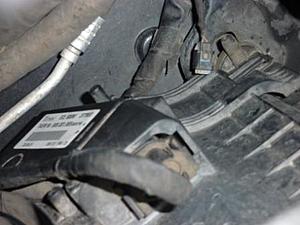

This distribution block is wired direct to the battery. Anyone know what is hooked up here? There looks to be an empty slot but I don't see the buss bar at this location. Is it possible to add a line here? Looking to run an amp in the trunk.

No 255 A 203 545 03 01 FUSE BOX JUMP-START PLUG SOCKET
Let me see if I can find a meaningful wiring diagram

Old Apr 18, 2012 | 12:40 PM
KalC240's Avatar
Joined: Feb 2011
Posts: 68
c240
Glyn,
could this loose connector located in the lower left area of the radiator be this part: 770 A 000 545 87 80 .DUMMY PLUG
BLUE NB ? Everything works fine so I don't know if this connector should be attached somewhere
I appreciate any input. Thanks.
Attached Thumbnails Battery distribution block under hood.-connector-003.jpg
