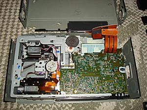

I bought the car with CD changer not working. I opened the CD changer carefully, and I saw 3 small motors (one for moving the cartridge in/out, second one for moving the arm to pick-up/drop-off the CD from the cartridge to the tray in the player, and the third motor is for moving the laser reader track-to-track. The motor that picks-up the CD from the cartridge wasn't moving, so lubed the associated gears and hit it (gently) with the back of the screwdriver. It started working.
Did you see a fan in the cd changer while working on it..??
There is no fan inside the CD changer.
