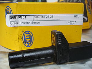

CPS location.
See 5 & retaining torx 11. Back of engine below the Drivers side head for US models. Access difficult.
Bosch or Hella are OE. Check RMeuropean for latest pricing.
Here is M272 pic. Same position on your M112.
