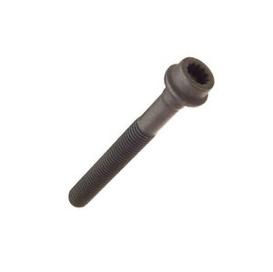

Part number on the head bolts?
Old Jun 16, 2014 | 10:37 PM
edgarinho10's Avatar
Joined: Jul 2008
Posts: 1,005
2013 UFO
102-990-08-10
Assuming my Google-fu isn't rusty.
Old Jun 16, 2014 | 11:14 PM
cm60k's Avatar
Joined: Aug 2006
Posts: 7,053
Likes: 398
From: A.D., U.A.E
If you mean this one, part # is correct...
