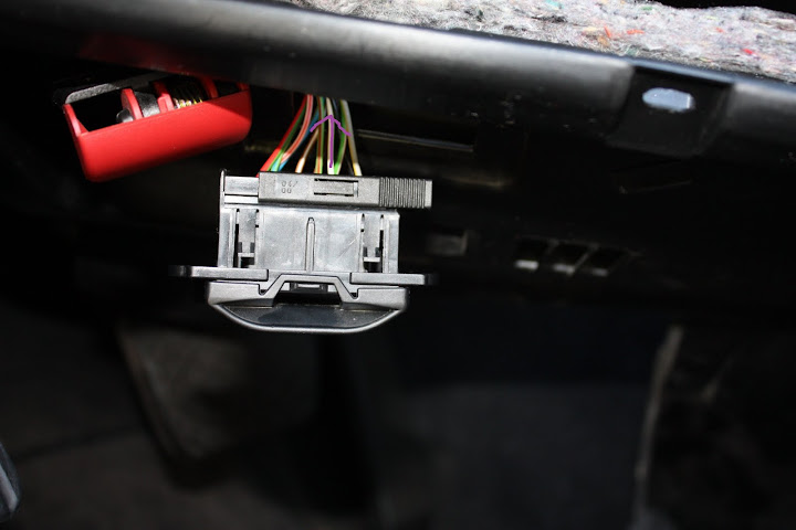

OK gents, finally it's the labor day weekend so I got some time to work on this. Following MW_ATL's steps, I like to provide additional pictures, and something I did differently on the hood release.
1. A quick look when the panel was first popped off
2. To disconnect the OBD connector
3. This is what I did differently from MW. With the hood release opened a bit, I removed the screw, and then massage/wiggle it out of the panel.
4. I have no idea what CANBus is, but I assume this is it:
5. Now you are looking at the cover just above the brake pedal
6. Push the foam aside and then OPEN SESAME
