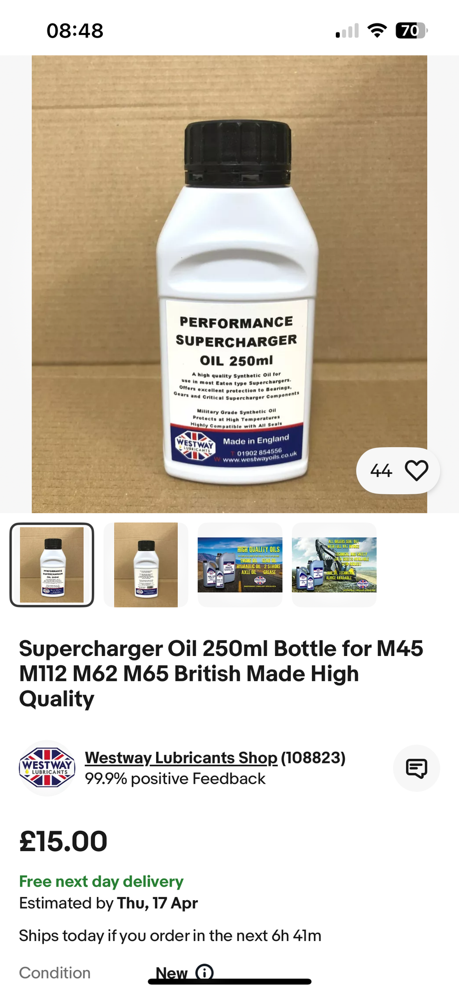

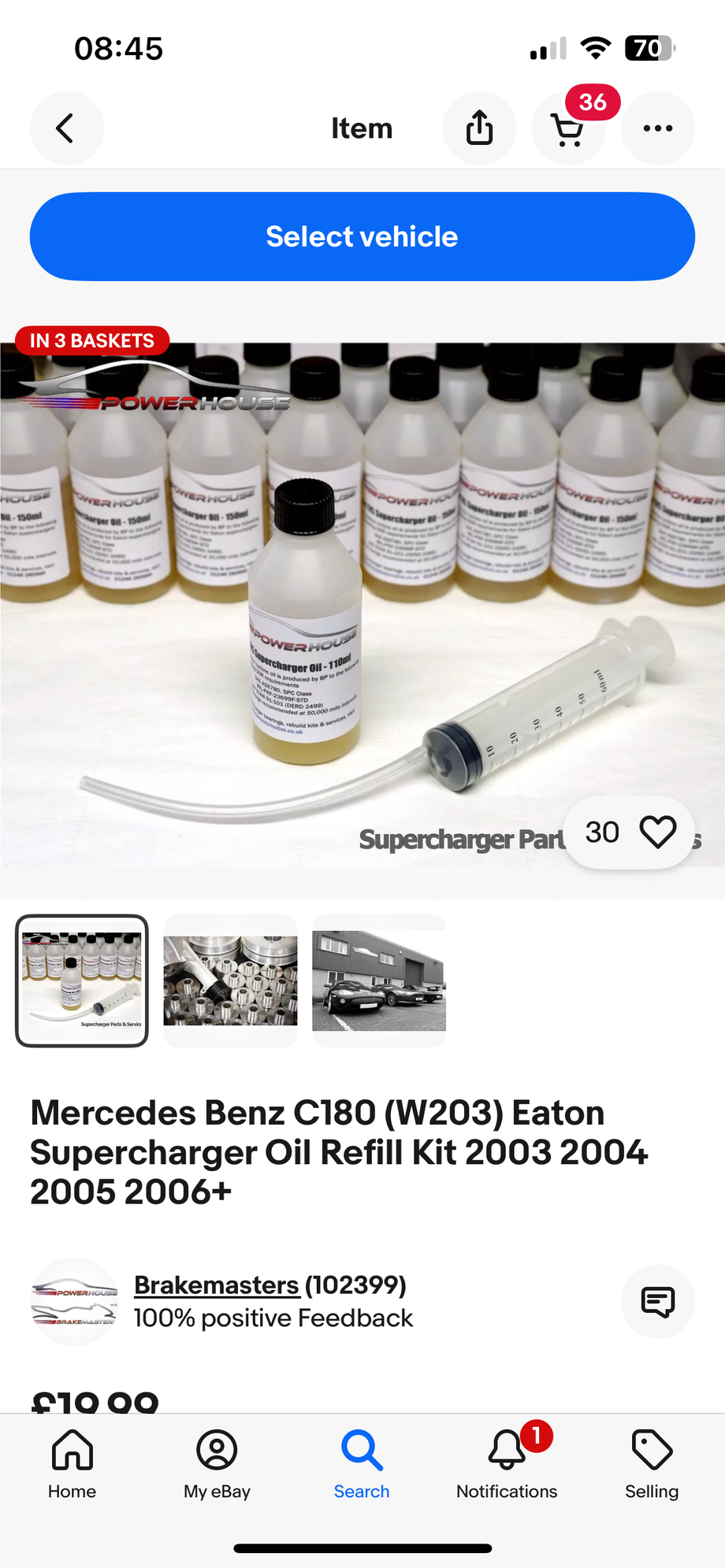

VKarp's Avatar
Joined: Apr 2025
W211
Found the following options on eBay.
Generally you just search for “Supercharger M Oil”:
