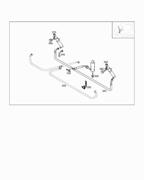

Hmm, this sure doesn't look like an easy place to reach.
Anyone have a drawing? I'd like to figure out where the seals are. I have to figure out how to get in there - it's very tight.

10 A 203 869 00 20 DASHPOT
WINDOW WASHER RESERVOIR 6 L. 001
20 A 203 869 00 14 HOLDER
30 N 910143 3006001 SCREW
WATER RESERVOIR
M6X16
Replaced_By: N 910143 3006002 002
30 N 910143 3006002 SCREW
WATER RESERVOIR
M6X20 002
40 A 203 830 03 61 HEATER UNIT
HEATED SCREEN WASH SYSTEM Code: 875
001
45 A 010 997 13 81 GROMMET
HEATER UNIT Code: 875
002
50 A 203 869 01 98 SEAL
WASHER FLUID RESERVOIR TO BODYSHELL 001
51 A 116 987 00 44 EXPANSION PLUG
WINDOW WASHER RESERVOIR CAP Code: -875+600
002
COVER 002
53 A 203 869 02 08 COVER
PANE WASHER RESERVOIR 001
56 A 203 869 00 98 SEAL
FILLER PIPE 001
60 A 221 869 01 21 PUMP
PANE WASHER SYSTEM 002
60 A 210 869 08 21 PUMP
PANE WASHER SYSTEM
Replaced_By: A 221 869 01 21
OptionPart_With: A 210 869 09 21 002
60 A 210 869 09 21 PUMP
PANE WASHER SYSTEM
OptionPart_With: A 210 869 08 21 002
60 A 210 869 11 21 PUMP
HEADLAMP CLEANING SYSTEM
OptionPart_With: A 210 869 12 21 Code: 600
001
60 A 210 869 12 21 PUMP
OptionPart_With: A 210 869 11 21 Code: 600
001
70 A 123 997 36 81 GROMMET
WASHER PUMP 002
70 A 010 997 11 81 GROMMET
HEADLAMP CLEANING SYSTEM PUMP IN RESERVOIR Code: 600
001
80 A 210 987 00 45 LOCKING CAP WIPER ARM
WINDSHIELD WASHER RESERVOIR WITHOUT PUMP
19 MM 001
100 A 220 540 00 45 SWITCH
WINDSHIELD WASHER WATER LEVEL 001
110 A 220 997 19 81 GROMMET
WATER LEVEL SWITCH TO RESERVOIR 001
120 A 203 869 00 17 PIPE
FILLER PIPE 001
122 A 203 869 01 94 HOSE
BREATHING 001
125 A 203 869 01 08 COVER
FILLER PIPE [900]
001
130 A 001 984 64 29 SCREW
FILLER PIPE MOUNTING
M5X16 001
160 A 203 860 13 92 HOSE
PANE WASHER SYSTEM [003]
001 L
160 A 203 860 01 92 HOSE
PANE WASHER SYSTEM
Replaced_By: A 203 860 13 92 001 R
PANE WASHER SYSTEM 001 R
HEATED Code: 875/600+875
001
170 A 000 995 61 44 CLAMP
AT ENGINE HOOD
6.5 X 14.5 MM 002 R
180 A 000 995 13 14 CABLE HOLDER INSTRUMENT C
AT ENGINE HOOD 001 L
AT ENGINE HOOD 001 R
190 A 203 860 01 47 NOZZLE
LEFT AND RIGHT
Replaced_By: A 230 860 03 47 002
190 A 230 860 03 47 NOZZLE
LEFT AND RIGHT [004]
002
190 A 211 860 11 47 NOZZLE
LEFT AND RIGHT [005]
002
LEFT AND RIGHT Code: 494
002
300 A 010 997 11 81 GROMMET
001
310 A 230 860 03 92 HOSE
PUMP TO NOZZLE Code: 600
003
320 A 203 860 00 92 HOSE
HEADLAMP CLEANING SYSTEM [006]
Code: 600
001
320 A 203 860 14 92 HOSE
HEADLAMP CLEANING SYSTEM [007], [006]
Code: 600+805
001
HEADLAMP CLEANING SYSTEM [008]
Code: 600
001
330 A 000 869 12 22 .DISTRIBUTOR Code: 600
001
340 A 208 869 00 24 .CONNECTOR Code: 600
003
360 A 203 860 05 47 NOZZLE
LEFT Code: 600
001
370 A 203 860 06 47 NOZZLE
RIGHT Code: 600
001
380 A 003 990 84 97 BLIND RIVET
AT FRONT CROSS MEMBER
4.8X17 Code: 600
002
390 A 007 997 26 90 CABLE HOLDER INSTRUMENT C
AT FRONT CROSS MEMBER Code: 875/600+875
005
AT FRONT CROSS MEMBER Code: 600
004
Attached Thumbnails Leak on drivers side-light-washers.jpg   Leak on drivers side-screen-washer.jpg

Glyn, you're the generous one as always. I definitely see a few places that I need to look at in that first drawing...now I just need to get a flashlight and get dirty....
