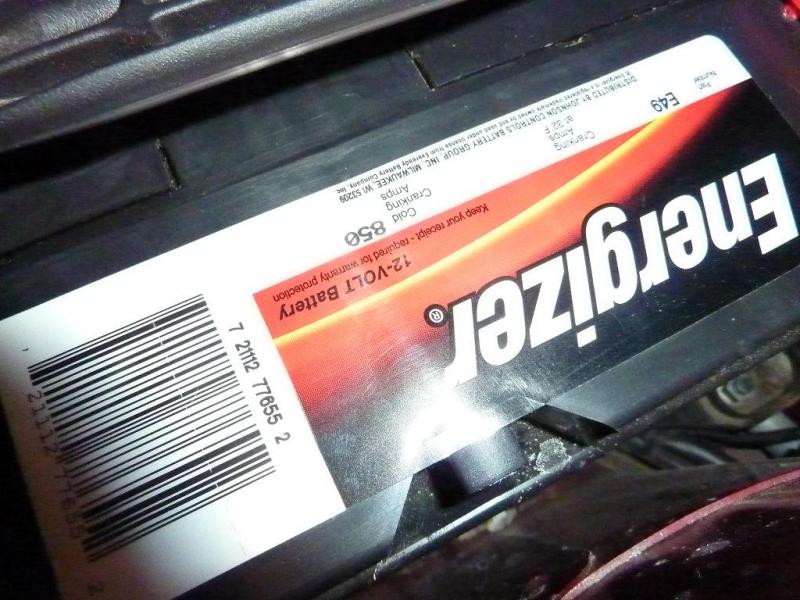

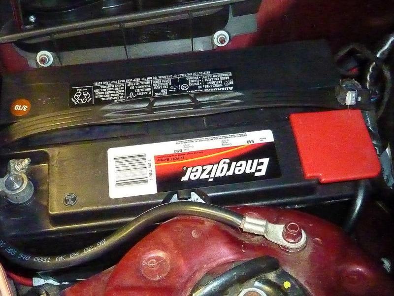

I was surprised to find the battery in I have is Energizer, did not know they made car betteries. Looks like it was replaced by previous owner in March 2010 or later. Anyone else has/had this brand and your experience with it ? thanks.
I did not know that Energizer was in the car battery business. It's certainly built to Benz spec externally right down to the red pos. terminal cover. We have the standard bunch here. Exide, Ray O Vac, Willard, VARTA, Bosch, Yuasa etc.
sounds good, hopefully it will last 8yrs but i will settle for 3 or 4. Thanks Glyn.
Those are made by Johnson Controls. AKA Interstate, Diehard and others. Typically good stuff - shouldn't give you any trouble.
