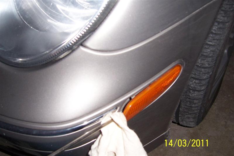

Does anyone know how to install these? I can easily take off the bottom cover under the bumper and do it but I was wondering if there was an easier way from maybe just popping the hood

Just use a small flat and and place it under the side marker and push it up. If you look at the ones your installing they have a bracket on either end, one end slides in to hold it in place and ther other end you use the flat head driver to push in and it'll pop out. You dont have to remove anything its like a 5 minute job.

So I jut tried to slide it first and I couldnt even slide it out of place...

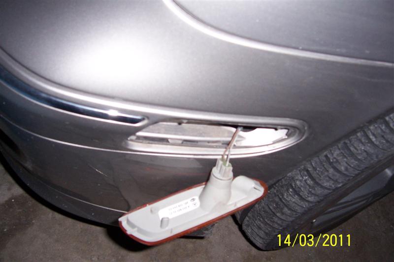

OK, You made me to go to garage and do DIY for you, you own me a
Attached Thumbnails In need of white side marker lights (?) for 02 C230 K-1.jpg   In need of white side marker lights (?) for 02 C230 K-2.jpg   In need of white side marker lights (?) for 02 C230 K-3.jpg   In need of white side marker lights (?) for 02 C230 K-4.jpg
