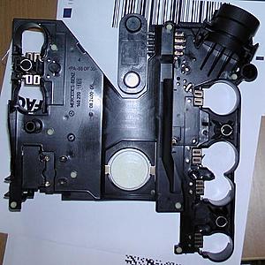

I would be pleased to know what the conductor plate is & its function ?

Conductor plate.
JC - consider it to be a glorified circuit board connecting all the electrical components such as speed sensors & solenoid valves together via the electrohydraulic bushing/plug & harness to the TCU. The solenoids etc. then act on the hydraulic "shift plate".
Some pics for 722.6
Attached Thumbnails 03 C240 Tranny Travails-transcon1.jpg   03 C240 Tranny Travails-transcon2.jpg

Thank you Glyn. At $1000 replacement cost , I hope that I do not see mine!!

They seldom fail in newer 722.6's. The part is only $150 but it's the labour that kills it.
