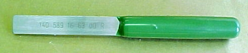

Here is the special Benz tool.
Attached Thumbnails Anybody know how to replace aluminum door trim?-mb140589166300.jpg

Thanks for the picture of the tool, Glyn. I have no idea how you would use it!
