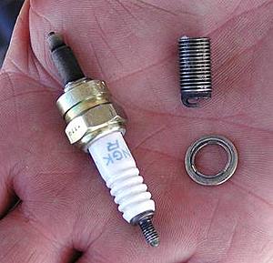

Old Jan 18, 2012 | 04:30 PM
Glyn M Ruck's Avatar
Super Moderator
Joined: Jun 2008
Posts: 19,942
Likes: 192
Nearly
