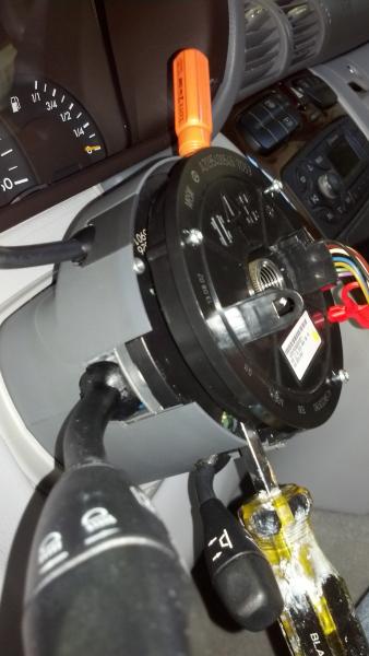

I have printed one of the DIY stickies on this procedure. I consider myself pretty good with this type of thing but I've hit a snag. The item in the picture that I am trying to remove is the steering angle sensor I believe. I'm gently prying on this to remove it. It doesn't want to come off. My question is am I doing something wrong here or do I just need to be more forceful. I don't want to break it that's for sure. Please help me.
Thanks
srb1194

I can't remember how I got it off, but it did take a little coaxing. Don't force it too much. I recall at some point it just popped out. Good luck.

The funny thing is it feels lime it's loose. Something is holding it near the 4 o'clock position. I spent over 2 hours gently working with it. Confused at this point!
