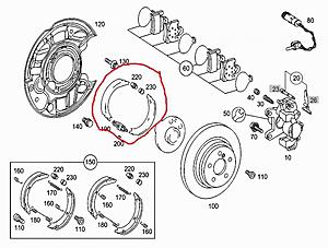

Experiencing a similar issue, except it seems the e-brake is literally stuck on what I think is the rear-right rotor.
I tried cleaning/lubricating the entire mechanism found under the rear seat to no avail so planning on taking the wheel off to do a visual inspection later today.
Can anyone suggest what to look for? I understand the e-brake is located behind the rotor so I'm assuming removing that would be the first step.
Old May 30, 2013 | 06:07 PM
Crna Mechka's Avatar
Joined: Oct 2010
Posts: 587
From: Boston
12 E350 4Matic Sport
Thought I'd post up in case anyone else experiences the same problem.
After removing the wheel and rotor, I found that the brake shoe which expands inside the rotor when you pull the hand brake was completely rusted out and falling apart. Ended up buying a new set popping it in and good to go!
Point of the story - check your break shoe (circled in the attachment) for wear!
