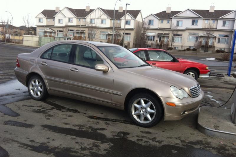

Hello everyone. I just picked up a 2001 C240 last weekend and am liking it so far! I had wanted one of these for awhile and was finally able to purchase one at a good price.

I'm sure there's more but this is all I can remember at the moment but I'm sure there's more. Hopefully you can see the picture.
