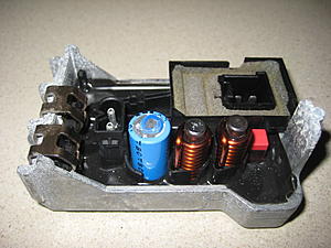

Then it's likely the fan regulator has blown or the fan motor itself is kaput or seized.

Fan motor regulator.

Meanwhile, I hope you're not telling me I can expect the rather expensive looking part you've posted to fail anytime soon.

Anyway ~ for the future watch that regulator.
