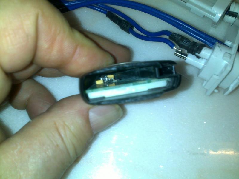

Hello everybody.
I need to clean and repair the printed circuit that is inside the electronic key . It is possible to see it on one picture?
Did any one ever succeed to pull out the printed circuit? Is there any procedure?
In advance many thanks
HAPPY NEW YEAR TO EVERYBODY
Attached Thumbnails Electronic key repair/ cleaning-220cdi-coup-cle-key-3-.jpg   Electronic key repair/ cleaning-220cdi-coup-cle-key-1-.jpg

The white nylon bar under the green circuit board in your picture retains the board with ramp latches. I use dental tools to lift the outer case off the ramps and pull the board out.
There is not much that can be repaired, except reattaching parts that have come loose.
