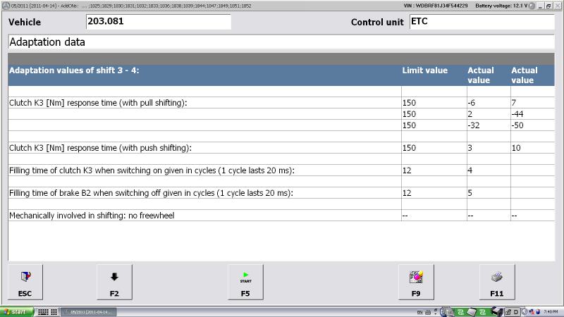

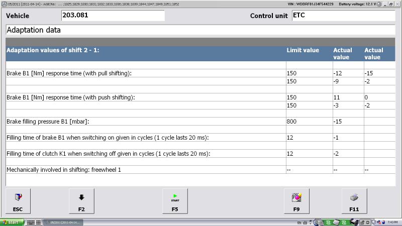

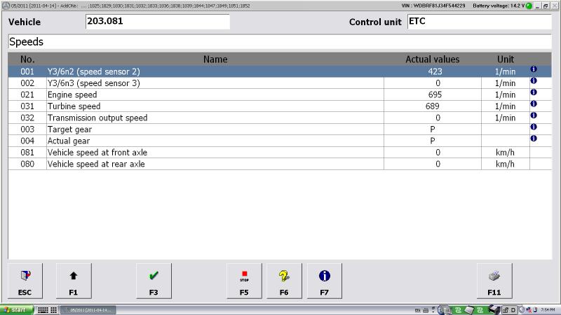

I want to thank Samaritrey for his help tonight. Using Star did not find any codes for my transmission, Found some things that were not talking well to each other but nothing transmission related. He reset the adaptations, the max for each would be 1400 and most were in the 20-30 range. There were a few in the negatives, I believe one was -2 and another may have been -30. Resetting the adaptations seems to have fixed the issue. The transmission shifts very smooth, at the right times, whether I accelerate slowly or quickly there appears to be no issue with the transmission shifting. The issues would normally start within the first minute of driving the car and after resetting the transmission I drove it for about 30 minutes stopping and starting a few times, turned off and on the engine once and so far so good.
So I will drive it tomorrow, holding my breath to see what was done tonight holds tomorrow. I am hoping it does.
If it does, any idea what could have caused it? I did have some issues with the Battery or Alternator, would voltage irregularities possibly cause issues with the transmission? Next thingI am going to do is take my car to get the alternator and battery tested.

Thanks to samaritrey I had my transmission adaptation values reset on my 04 C240 4Matic. When he hooked up Star found a bunch of readings in the negative. Anyone with transmission knowledge know if these negatives could have been the reason for my transmission shift problems. <knocking on wood> since he did this on thursday my car is driving great with no transmissions issues.
If this was the cause, anyone know what may have been the reason, what I can look to get checked to ensure this does not happen again?
Thanks again!

Low voltage could have caused some of your issues. Resetting adaptions was the right thing to do.
The transmission must be serviced every 60K Km's or 39,000 miles.
Service & monitor the performance. You might have a conductor plate going out but the problems could have been caused by low voltage.

Yeah and with your complaints about the occasional low voltage error and the possible original battery that could be your issue. I did check my adaptations and had negative numbers in some places as well but my TCU displays everything differently than yours did. I saw a special at the MB dealer in town (don't want to name the one but it is the closest one to our homes) that they will do a free battery testing and car wash (useful this time of year) they will probably want to charge you a crazy amount for the insulation so while you are waiting for your car go to the parts counter and get a battery quote (make sure they use your vin) I know it will be expensive so then call the other local dealers and see what the cheapest is. I know it is more than a parts store battery but how often can you find a parts store battery that will last 6-10 years on a regular basis. I am going to take my car in soon to have it checked out as I think it is going bad and my car is caked in salt.
