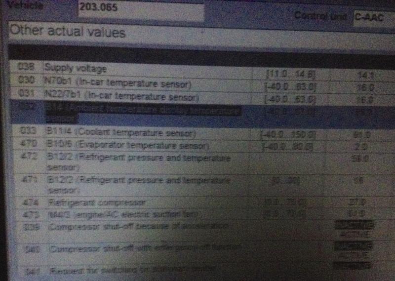

2003 C32 with C-AAC
Symptoms, 95% of the time the A/C functions correctly:
B1020 Evaporator temperature sensor code
AC continues to run for a few seconds after key is turned off.
AC blows hot air on low temp setting.
AC doesn't blow at all with fan set to max.
My thoughts:
Because the AC would stay on after the key turns off I'm guessing the Front SAM is intermitantly failing.
Has any one had issues like mine?
Intermittent AC problem, AC blows with key off, SDS pic-img_1803_zps4e219432.jpg

Front SAM ordered.
