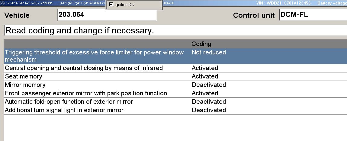

By chance did you ever have the door control module replaced? I was curious and looking through DAS and remembered that you can change the adaptations for memory seats and mirrors. Technically you could have mirrors activated and not seats and maybe that would explain your situation?? Just another thought.
Attached Thumbnails set memory not working-2015-08-19-18_48_23-12_2014-2014-10-29-addons_-....-4173-4177-4115-4162-4068-4118-4158-414.jpg
