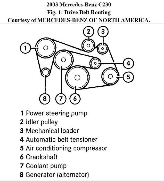

Do You think removing the belt and checking pulleys makes sense? I think it's not a big deal and it's always good to check, but I have never done it before... Will I manage to do that? I'm afraid of assambling it back. It looks like here is also not much free space to work between the pulleys and intercooler...

Originally Posted by VVF
As to the belt removal/free space: MB M271 - Cambiar la correa de accesorios - YouTube
Also here is a Diagram to help kno how the belt goes back on

You guys are awesome. I am very grateful
