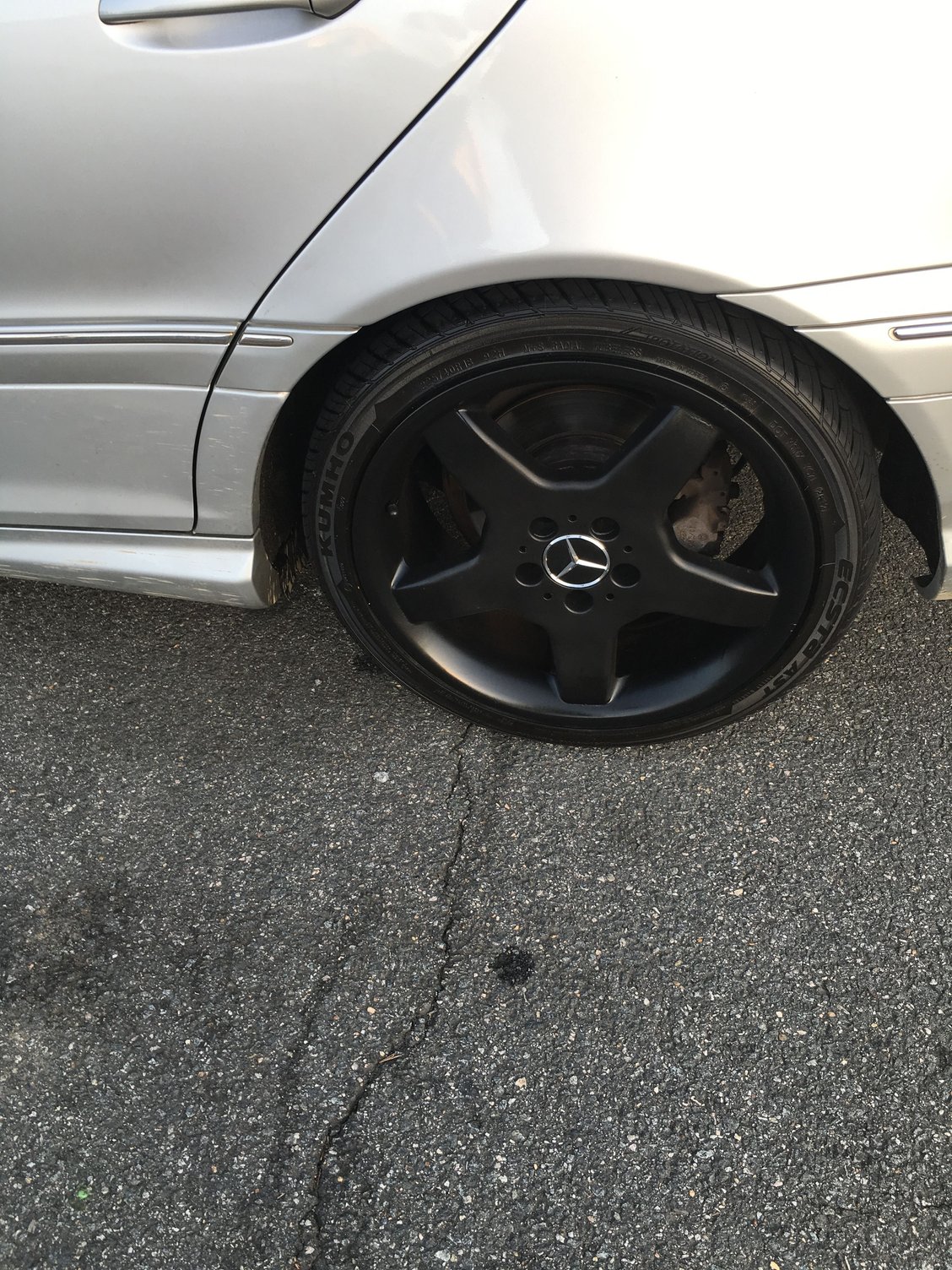

Hand painted plastidip wheels with new center star; 18" wheels don't reduce ride quality but doesn't handle quit as sharp due to additional wheel weight I guess
Wheels came out nice!

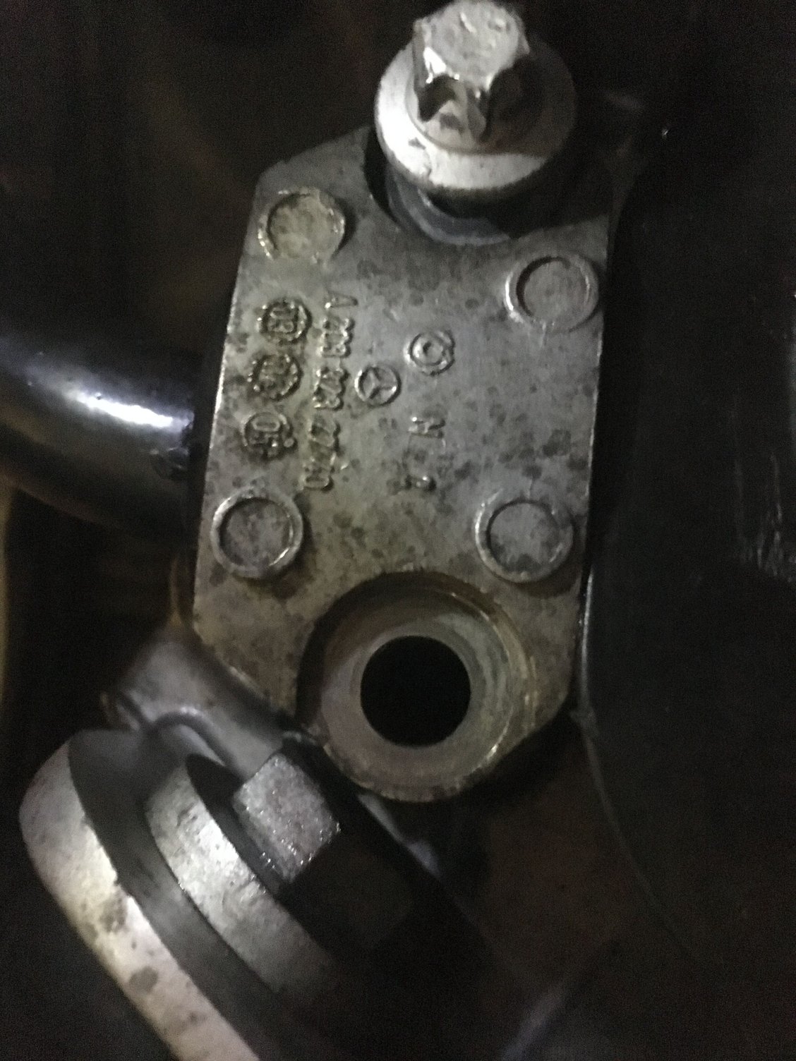

Purchased the front H&R sway bar this weekend. Turns out I did indeed need the larger brackets and purchased them as well. In the pic, you can see the smaller brackets which I verified with the visible part number. Also decided on the bar with the 12mm end link hole because of what I have read on this forum for the sport model of our car, as well as rough measurements while under my car. Will let everyone know how the install goes, fitment, and ride! Hopefully if I put it in the ti
ghter hole in the front the ride will enjoyable just like when I put it in the tighter hole in the rear!
This is the smaller bracket for front right; had to purchase bigger bracket
