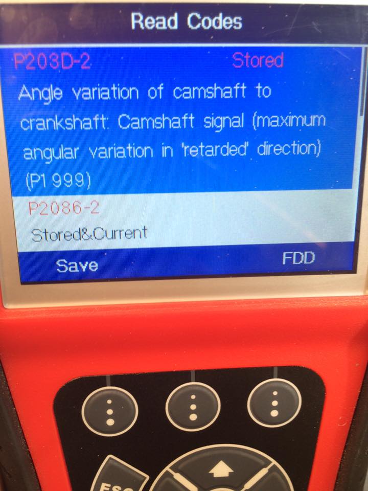

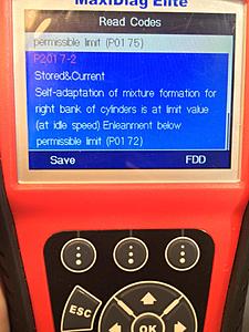

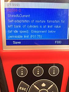

hello guys
AM I HAVING SERIES ENGINE PROBLEMS ??
my ride is benz 2001 c320 m112.064
my scanner just gave these codes
p2017-2
self-adaptation of mixture formation for
right bank of cylinders is at limit
value (at idle speed). : Enleanment below
permissible limit (p0172)
p2086-2
left bank of cylinders is at limit value
permissible limit (p0175)
__________________________________________________ ________
I searched the forum and came up with some things to begin with like
fuel filter, maf sensor, vacuum pipes , i think i can deal with these, but what bothers me is :
p203d-2
Angle variation of camshaft to crankshaft: Camshaft signal (maximum angular variation in 'retarded' direction ) (p1999)
, is it series ???
any help would be appreciated
thanks a lot.
photos with errors in scanner attached
Attached Thumbnails M112.064 ENGINE error code P203D-2  PLEASE HELP-12421724_986282331487994_100598231_n.jpg   M112.064 ENGINE error code P203D-2  PLEASE HELP-12900024_986282354821325_573963120_n.jpg   M112.064 ENGINE error code P203D-2  PLEASE HELP-12910801_986282111488016_355193191_n.jpg

How does the car run?
How many miles?
My guess would be the Mass Air Flow Sensor which is made by Bosch and if you do replace it make sure to get a genuine Bosch one as the cheap aftermarket ones seems to cause issues. I got mine on Amazon for around $115. Wish I saved my old one as it was working fine.
Do you have access to a more sophisticated diagnostic software?
I have not heard of the p203d-2 code but notice it says stored and not current so it may be an old code unless you have cleared it and it came back. I believe that a worn timing chain/bad tensioner could cause this as that is what keeps the camshaft and crankshaft together but unless you have high miles or poor maintenance I doubt it is that and could just be a bad sensor.
I have found after scanning many peoples cars with STAR that the dealer rarely goes back and clears codes after doing work. So if a sensor went bad years ago it may still show up as a pending code. With STAR you can look at the details and see when that code was last relevant.

thanks samaritrey for your replay
the car runs fine with 124274 miles, and i think i can access to more detailed info like 'live data', i keep clearing the code p203d-2 but it comes again.
what sensor you are referring to , i.e camshaft or crankshaft sensor ?
worn timing chain/bad tensioner wtf
i will keep looking\investigation hope to find the malfunction part.
